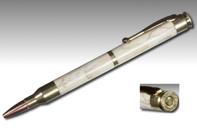

Well, a pretty piece of antler, anyway.
redfishsc
Feb 11, 2006
2,545
North Charleston , SC
That is nice antler, but even nicer craftsmanship. I love the clip finial!
The antler almost looks like marble. Nice selection of materials and kit.
alamocdc
Apr 26, 2005
7,970
San Antonio, Texas, USA.
I agree, Eric, but not at all what I was expecting. [}:)][;)] So you got me. BTW, that looks like an unspent primer in the end of the casing. [?] Or did you replace it with something else?
Sylvanite
Jul 18, 2006
3,113
Hillsborough, North Carolina, USA.
Originally posted by alamocdc
<br />... that looks like an unspent primer in the end of the casing.
It's an empty primer cup. The customer wanted a pen of this style made from his antler and ammo, so he gave me a piece of each. I disassembled the ammunition, disposed of the powder and priming compound, drilled the bullet, cut the case, turned the antler, and reassembled everything.

Thanks for the concern. I don't believe that primers are anywhere near as sensitive to contamination as claimed and would never trust oil to "deactivate" one. The only sure way to render a primer inert is to fire it. Therefore, I put the primer behind a lexan shield and cooked it off. There's no pellet nor anvil in the primer cup anymore.
I go back and forth on whether to use a struck primer (with an indent from a firing pin), or unstruck (as shown). I like the unspent look (because the bullet is still present) but I spend a lot of time explaining that it isn't a live primer.

I appreciate the sentiment, but a lot of credit should go to Don Ward (aka its_virgil) who has been making pens like this longer than I have been making pens at all. If you look at http://www.penturners.org/oldalbums/its_virgil/4 bullets Nov 03.jpg you'll see that this design is mostly derivative. About the only original thing on this pen (meaning I haven't seen anyone else do it before) is using the case head as the finial. Even that was just a matter of doing a hidden clip, which has also been described elsewhere.

I hid the clip using a technique similar to that described by Bill Jackman (bjackman) in http://content.penturners.org/articles/2006/recessedpf.pdf. The main difference is that the clip is held in place by a snug fit between a tenon on the antler, and the inside of the case head, rather than by a modified pen kit part.
Mike Vickery (VICK) also gives a method in http://content.penturners.org/articles/2005/invisibleclip.pdf.
Both credit Russ Fairfield for the idea and I understand he has tutorials over on the Pen Maker's Guild (et. al.).
So, thanks to Don, Bill, Mike, Russ, and the countless others who's lessons have been invaluable to me.

I've thought about that. I already sell 30-06 and 308 cartridges with bullet nibs drilled and sized for slimline/euro kits. I've also made and would consider selling versions drilled and sized for cigar or perfect-fit kits.
I just got a mini cut-off saw, and plan to make jigs for cutting rifle cases. If that works out, it might save me the step of truing and facing the brass on the lathe (which would be necessary to offer a kit at a reasonable price).
Still, it wouldn't be a kit for beginners. This pen has tenons on both ends of both barrels and takes a good bit of care and test-fitting to get right. That brings me to my main concern. Just how much of the pen do you want me to supply, and how much do you want to craft for yourself? So far, I've limited myself to the things that require special tooling, or special care beyond the means of a typical penturner. That is, I buy the components in bulk, drill them out, and assemble to appropriate dimensions. I don't provide slimline kits, glue in tubes, or install transmissions. These are things that I think we all are capable of and most would prefer to do for ourselves.
A cut-case pen takes a bit more skill than one using a whole cartridge. I could reduce that requirement somewhat by providing the cut pieces, but would you really want me to?

Cutting the slot for the clip was the second operation on this pen (modifying the clip was the first). I put the case in a vise oriented so the headstamp "R-P" would line up with the clip. Then I cut a line into the case using a regular hacksaw marking where the slot would go. Next, I plunge-cut through the brass with a small cut-off wheel on a Dremel tool - just deep enough to expose a hole. Then, using a hacksaw blade that I had ground down the end to little more than teeth, I widened the cut to form the remainder of the slot.
