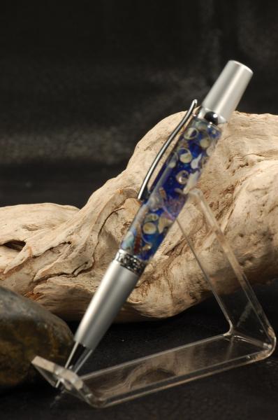

Here's a sea shell pen I made with "Cobalt Blue" vinyl. The vinyl sure makes putting sea shells on a tube easier as CA melts paint! It was then cast in Silmar 41.
Sorry for the crappy photo.
