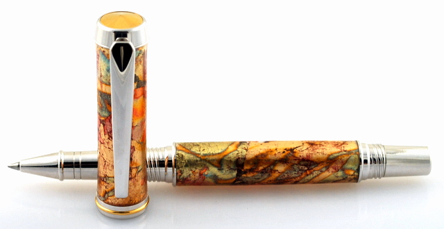

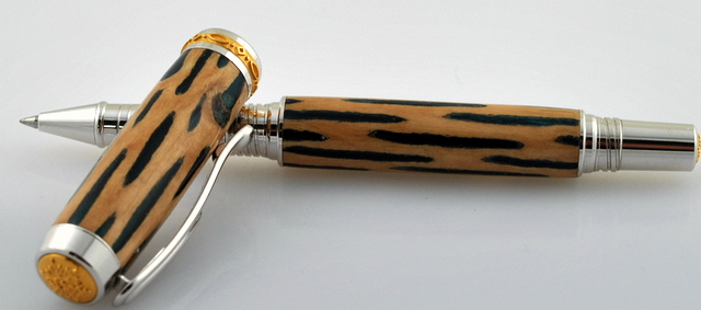

I think you really might be asking about the Jr. Statesman with a gold filigree centerband. It uses the same tubes as the Jr. Gent 2, it's actually just a nice upgraded Jr. Gent 2, which has a Rhodium or Titanium center band with a gold ring
Here is a photo of a Jr.Gent2
Here is a photo of a Jr. Statesman:
Both of these are available at a number of Vendors here, CSUSA, Classic Nib, and as far as I know Exotics.
