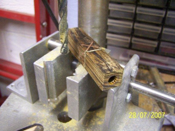

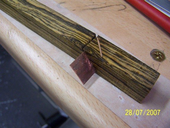

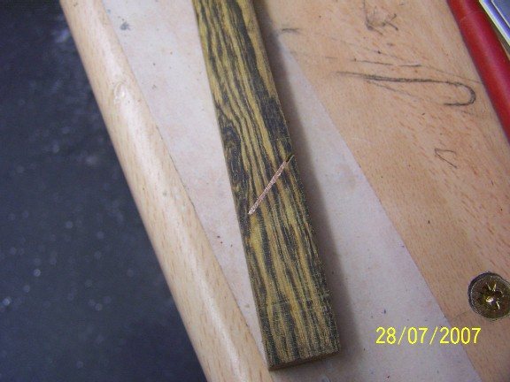

No matter which way you cut your blank when making a cross ( Celtic Knot ) don't cut all the way through. Use a slightly bigger blank and just cut about 3/4 the way through. This means the blank will always stay perfectly aligned. If you use a tablesaw then lower the blade. If you use a chopsaw, then raise the blade using the depth stop. If you use a bandsaw you could do what I did. Just put a clamp on the end of the mitre slide to act as a stop. Hope this helps:D
First cut, see how it doesn't cut through the blank completely

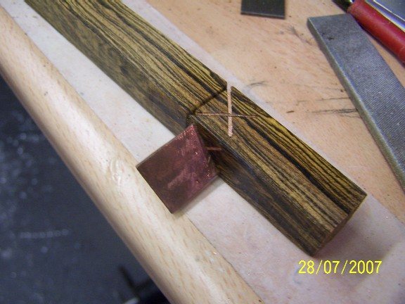

Second cut...
Fourth cut...

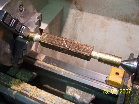

Drill and add tube...
Turn as normal...

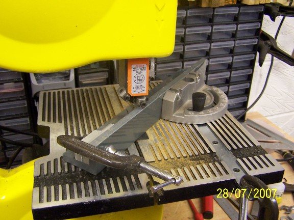

Heres how I cut for thin stuff....
The clamp on the end of the mitre acts as the depth stop ( and prevents me cutting all the way through my zero clearance fence:D)
Hope this helps:D

Don't think a "dummy" would come up with this! [:D] Excellent tip, you can now instantly tell if the added piece is the correct width of the material you are taking out.

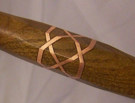

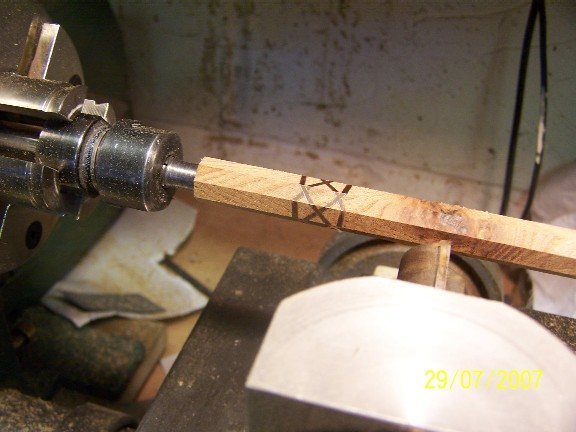

I snagged the Bocote blank[:(] Blunt tool!!!
So I made another one with a piece of oak from Andrew( UKpenmaker )
This is still on the lathe, but I'm reasonably happy about the way all the lines are still aligned. The 'flat' is a bit out but I can bring it back with a little more biased sanding. You can see how much I've corrected it by comparing with the second pic. I got the router way out[:I]
<br />
<br />
