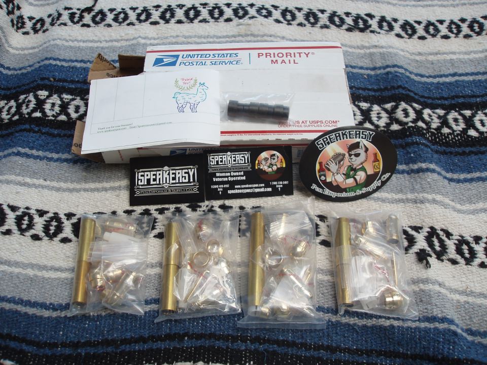

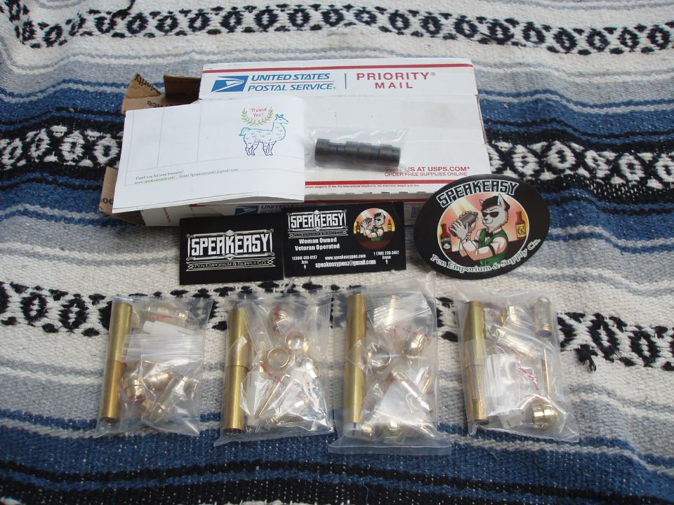

The four kits and bushings arrived in the mail this morning. I downloaded the instructions from the website. I won't have time to make one for a few months, so don't hold your breath. I just looked, and they are sold out.
