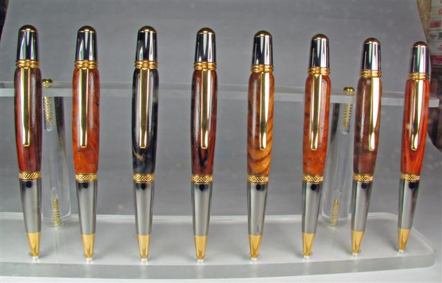

Sierra Twists in Black Ti., & Ti. Gold.
L to R: Cocobolo, Golden Amboyna Burl, Ebony, Cocobolo, Chechen, Thuya Burl, X-Cut Walnut Burl, & Cocobolo.
Finished with 2 coats dewaxed sanding sealer, 7 coats of 4 hr. poly, wet micromeshed 6,000 - 12,000 followed with 2 coats Renaisssance Wax.

Great collection Mack. I read your finishing procedure with interest. I have had problems in the past applying poly to cocobolo and figured the next time I would put sealer coat of dewaxed shellac first before the poly. It obviously worked for you. Did you wipe it on or spray it on? I'm also assuming you did not have to wait to long before applying the poly, as quick as shellac dries.
Hi Keith; I brushed the sealer on with a ½" angled brush I bought at Michaels.
My finishing protocol, when I use 7 coats of fast dry poly, brushed on as well, is to get at least one coat on after supper time. I usually give each coat of shellac a ½ hr. more or less to dry. Test with fingers. 1500 mm btwn coats.
Next day 3 coats of poly, wet 4,000 mm btwn coats, next day after that 3 more coats, no mm between coats. Let cure for 24 hrs, I actually get 36 hrs. since I finished the prior evening.
Then it's wet mm 6,000 - 12,000, Renaissance Wax and I'm done.

Once again your work is outstanding. The line up is all well matched. That is a rich looking kit.Nice job with the finish as always. Doing a bunch of pens like that at one time is actually not so time consuming when you look at it. Keep up the great work.
