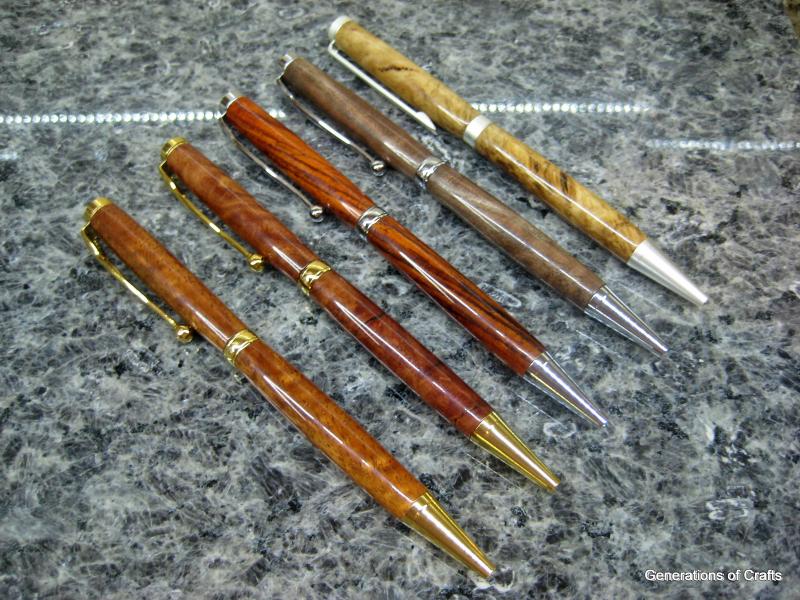

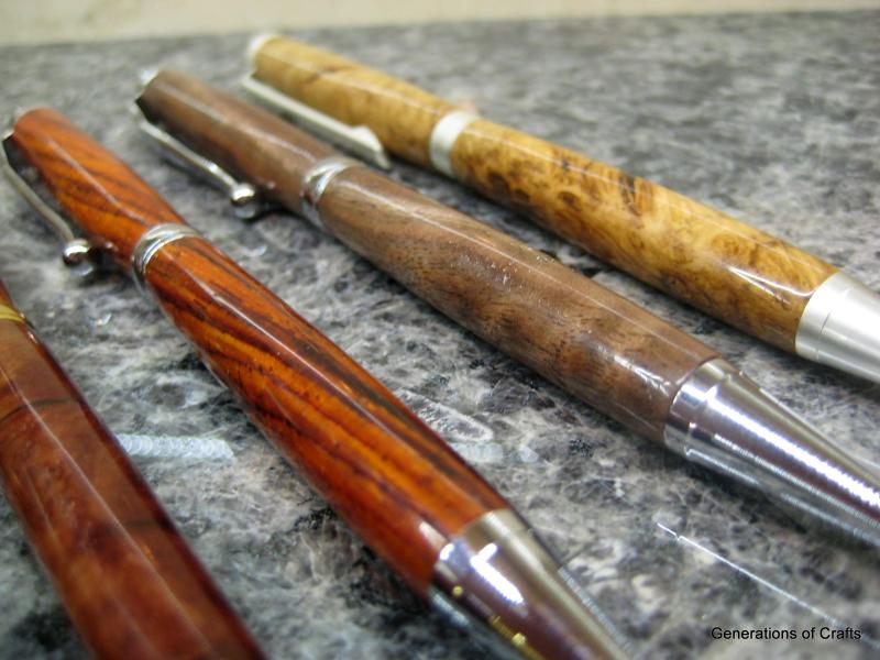

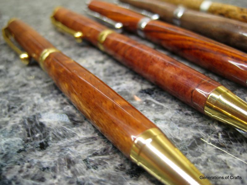

I am increasing my slimline inventory because of a fair in a few weeks...here they are from left to right:
Curly KOA
Amboyna Burl
Bocote
Claro Walnut
Brown Mallee Burl
Thanks for looking and of course, any feedback is welcome and appreciated.
