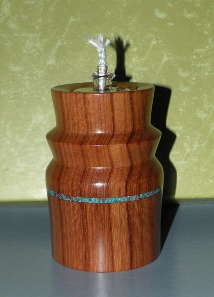

Here is a photo of the Confetti light I turned yesterday. The wood is Hormigo, which I love to turn. The figure is beautiful and it finishes well. I inlaid a small line of turquoise. Sorry--the photo is not great...just a quick one for this post.

Carmen I really like that wood. The grain is spectacular and I like the turqoise inlay. Is that the hormigo negro that Woodcraft sells? I've seen it there before but never really gave it much thought. Might have to take a look for a piece the next time I'm there.

The Hormigo is from Woodcraft and it is relatively inexpensive compared to some other species. I use it a lot. Try it. I think you will like it.
