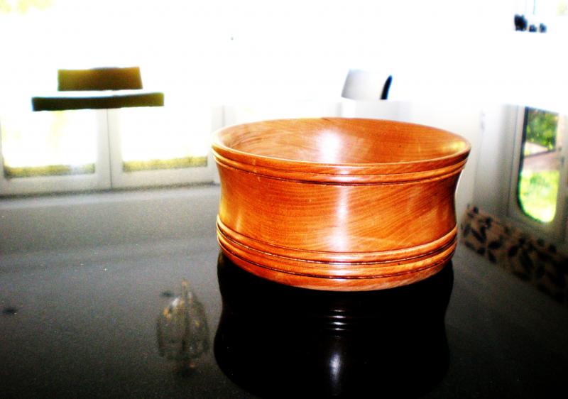

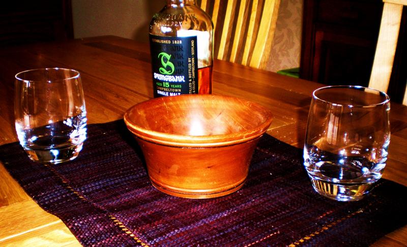

I made these bowls as practice, im trying to learn how to do it so please do let me know what you think!
Cheers
Ollie

Your off to a great start! Couple of things, the walls could be a bit thinner....1/4-1/8 inch is generally accepted as your target thickness. Personally I'd like to see a bit more shape and less beading, but thats my taste. A footed bowl will appear lighter, these are a bit "blocky". Keep at it these are better than my first few bowls.

You've done very well, for the first attempts...!
Turning bowls can look a little daunting at the start but, the main trick to it is to acquire a couple of tools that will make bowl making a breeze, regardless of size.
For the outside the bowl gouge is a must and for the inside, where the difficulty is and where most people find it difficult, with certain woods and in end-grain hollowing, the most efficient is the carbide round cutter. These are found on sale everywhere in our days and you have here someone that makes and sells them.

Your shapes, thickness and decorative cuts are most typical from beginners in these type items, everyone, including myself didn't start making thin walled turnings and more elegant shapes, from the start, in fact, the wall thickness in one of the areas where you will need some common sense. What I mean is, for now, and while you are getting used to these type turnings, thicker wall thickness = safe, some items can do with thing walls but certainly not all, in fact, most usable items, particularly in the kitchen (salad, fruit bowls, etc...!) do require a "reasonable" wall thickness for stability and durability, particular if kids are about.
Don't panic, you are oof to a great start and it will get easier and better as you go, we all have been there, done that...!

Nice beginning! It can always be a bit intimidating to start doing larger turnings. I would recommend trying forms with more flowing curves. Imagine the major flow of the form appearing to just kiss the surface it rests on.
