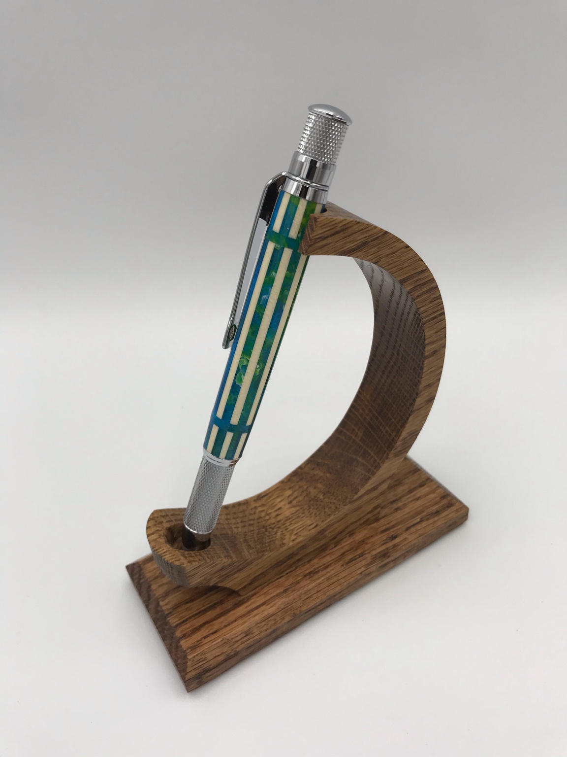

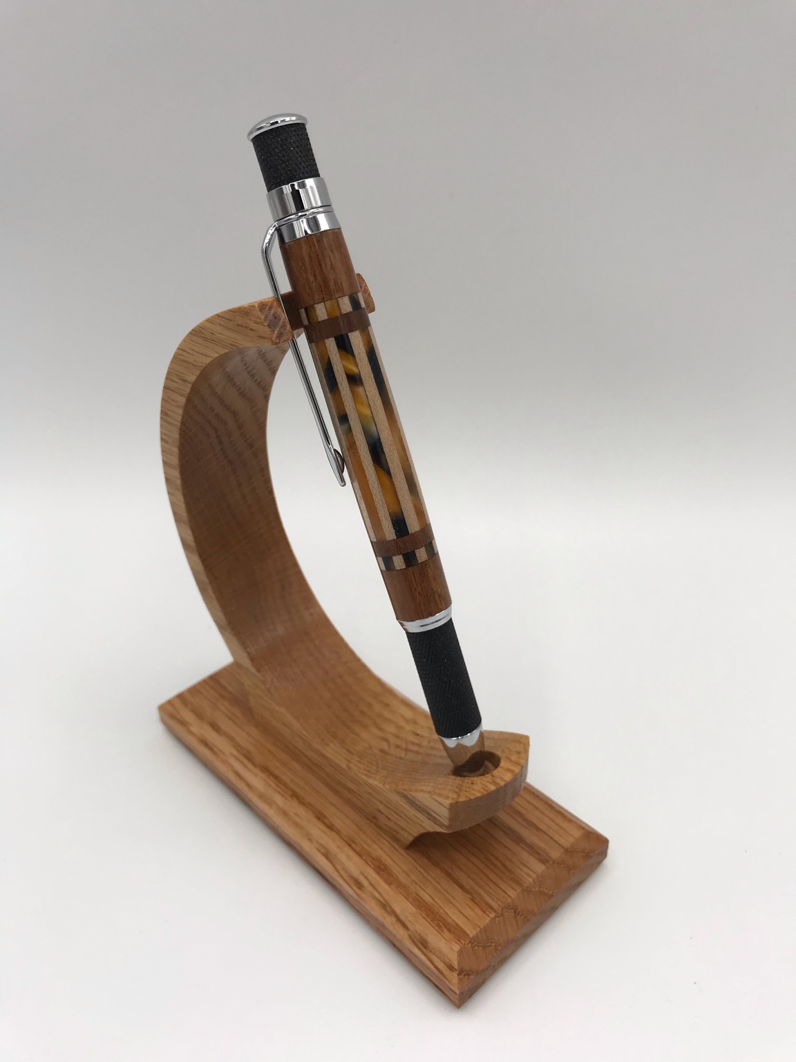

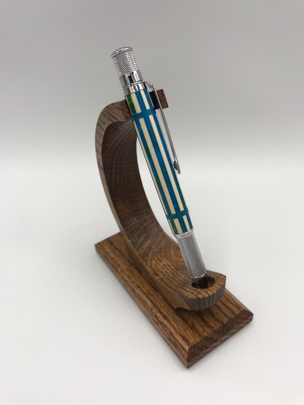

I don't do much acrylic and these, I believe , are my first segmented pens that incorporate acrylic. The blue one is holly with a blue, green swirled acrylic. The other one is maple, chechen and black, gold swirled acrylic. Both pens are GT Knurls , one chrome, the other, black and chrome. Funny observation, I told my wife , I have no idea why, but the blue one makes me think of The Beach Boys. She looked up pictures of them from back in the day, and it seems they wore blue and white stripped shirts a lot. Critiques always welcome.

Nice work, Ken !!!
I'd like to know, please, how many longitudinal sections there are on each pen. . Looks like about 16.

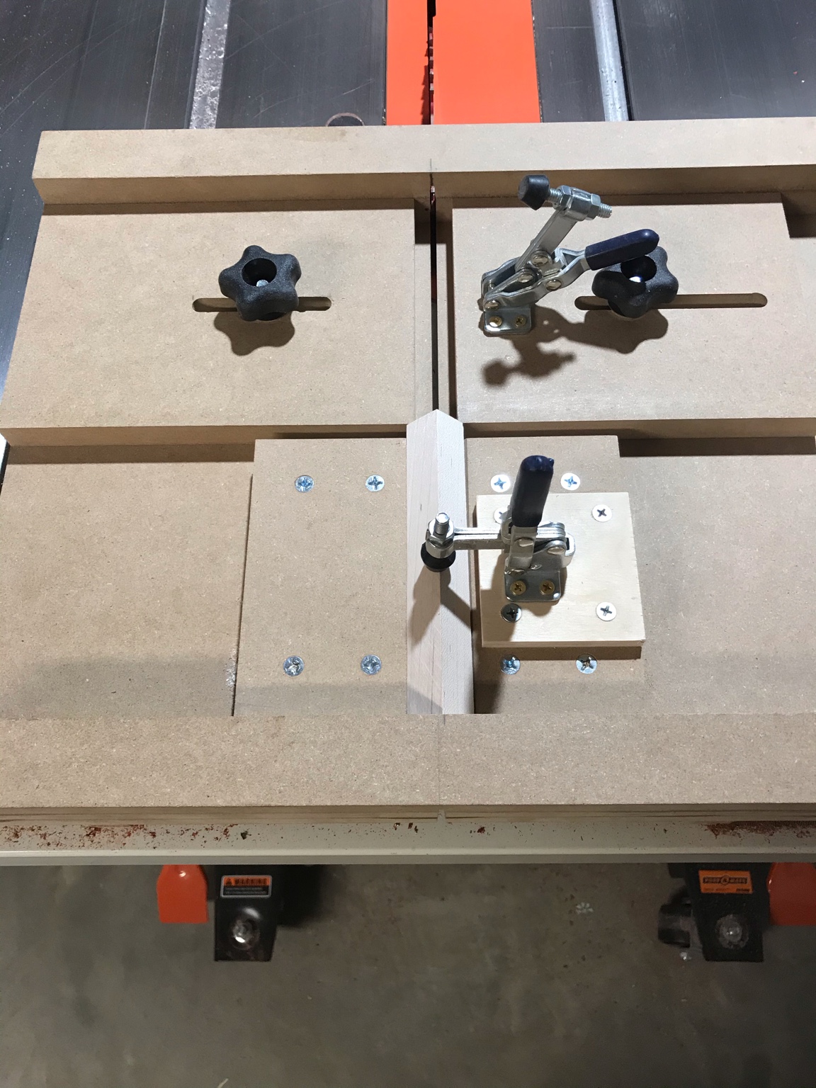

And how do you do the longitudinal cuts ? ... table saw, I suppose, but done when the blank is square cross-section or after it has been rounded ? . Maybe you have invented yet another jig for doing those cuts !!

You're right on both counts. There are 16 sections. They are cut whilst the blank is square on my table saw and of course I made a jig for it [emoji16]

Beautiful duet Ken! I love the combination of materials and the precision is as typical superb. Very nice to see more of your artistry.

Very nice! I would love to see the jig and make blank with vertical lines only.

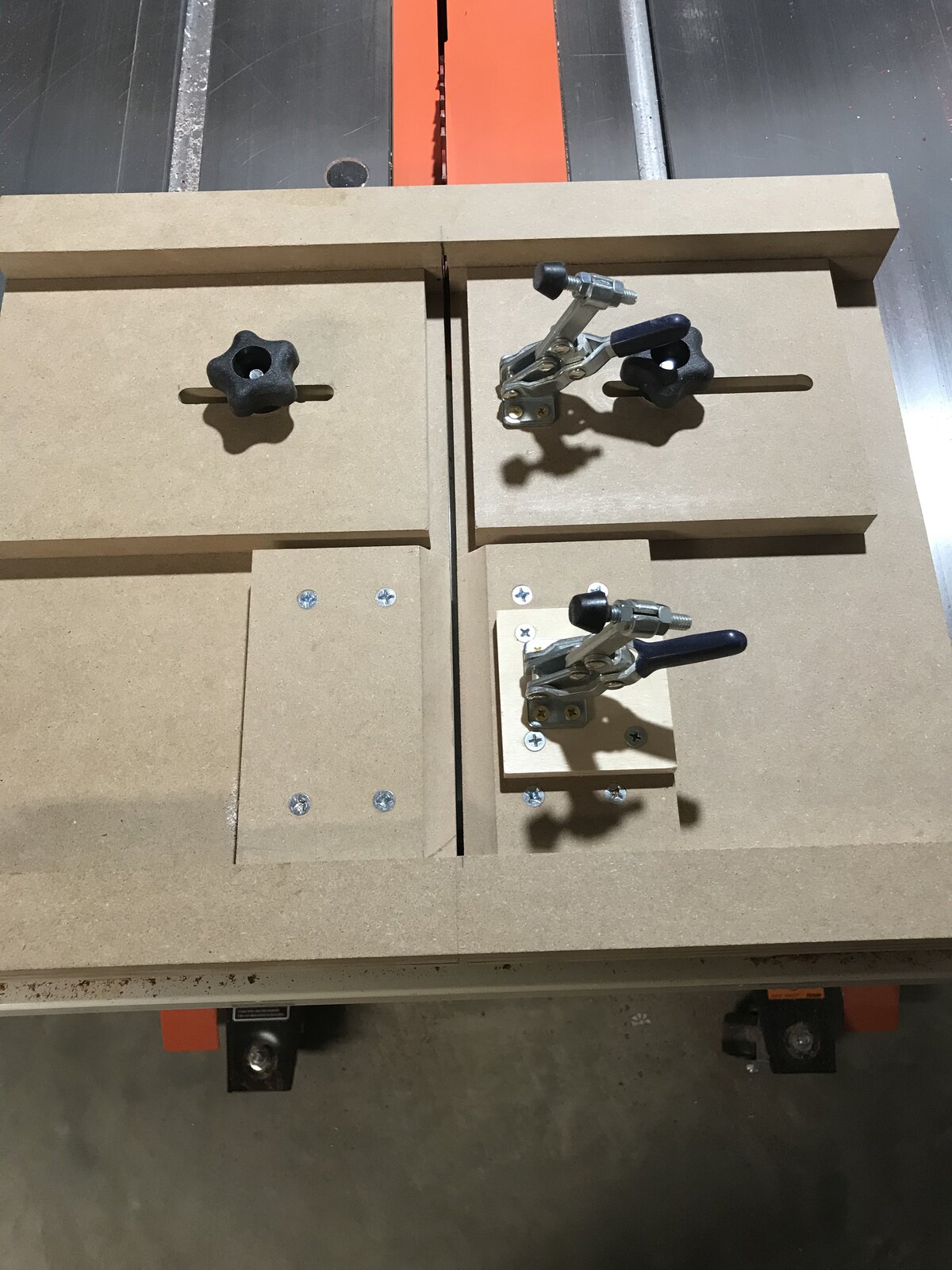

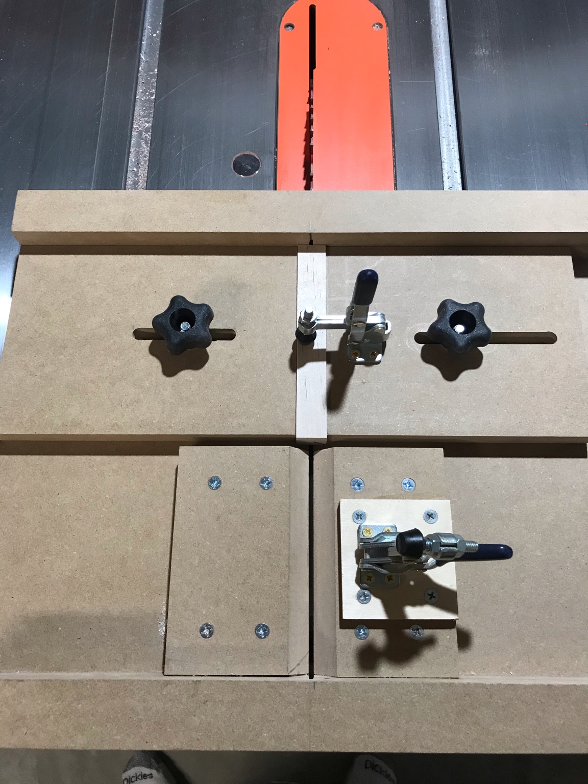

Pretty simple jig. Blank is held at 45 degrees in the front and laid down flat in the back. You can cut any number of slots by turning the blank round and then just put a reference mark on the blank as well as the jig, all these cuts would be made in the front section. Only thing that's required for this jig to work well is a perfectly square blank.

You could also do staves or use my jig and use a router or you can make a jig like he did and still use a router and then can adjust the size of the slots to whatever you want. Can vary them too. Need to think outside the box when it comes to segmenting. Many ways to achieve the same look. I like the use of wood incorporated with acrylic.

I have a similar jig to this for my router table too , but I like the saw better. I can vary the slot width on the back by cutting it ever so slightly off center and turning the blank around and cutting it again. It will be perfectly centered but a little wider.

Whatever works for you. For me I router on my lathe and can do any size slots or amounts and with an indexing ring I can make any combination but that is just me the way I do things.

Nice looking pens - alignment is spot on and the use of both acrylic and wood is well done. I made a similar jig for my bandsaw, but was making through cuts rather than partial cuts. I've used a jig on my lathe with a router to cut slots in a rounded blank. I believe Mark James does his that way.

I think it would work on a bandsaw. I believe the infill would have to match kerf to keep the blank square. You could cut all the way through or leave a section on the end uncut. Either way would probably work.
