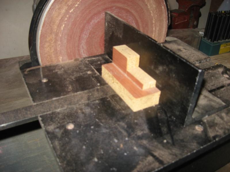

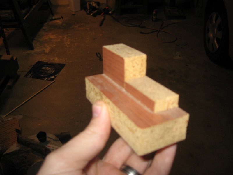

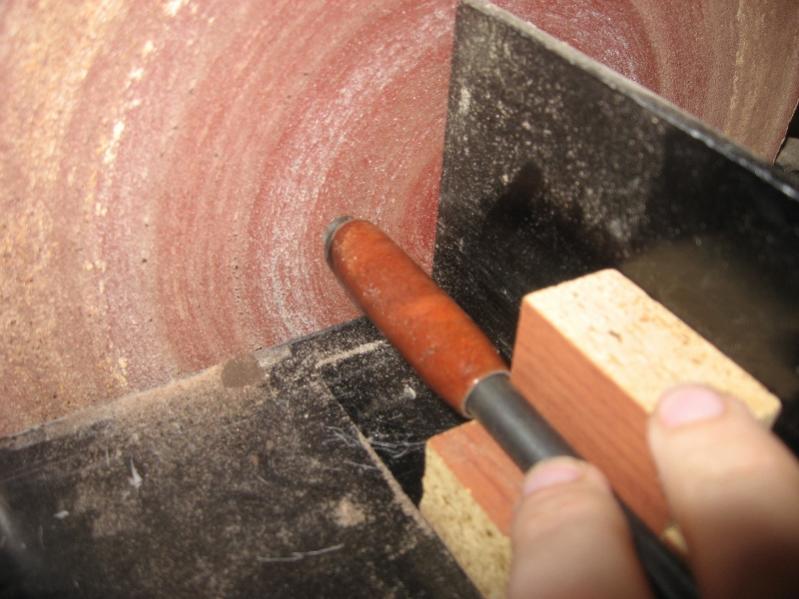

If you're looking at other, cost effective solutions and have access to a disc sander, you can buy the transfer punch set from Harbor Freight. I haven't found a pen yet that doesn't have a punch that fits the tube snug. Drill and glue your blank, insert the appropriate size transfer punch, build a simple jig that will keep your punch square with the sander and sand till you hit the brass. When I say simple jig, I mean simple - here are a few pictures showing my jig and how I use it. It took about 30 seconds to glue together, it's never failed me and I've been using it for about a year and a half.
