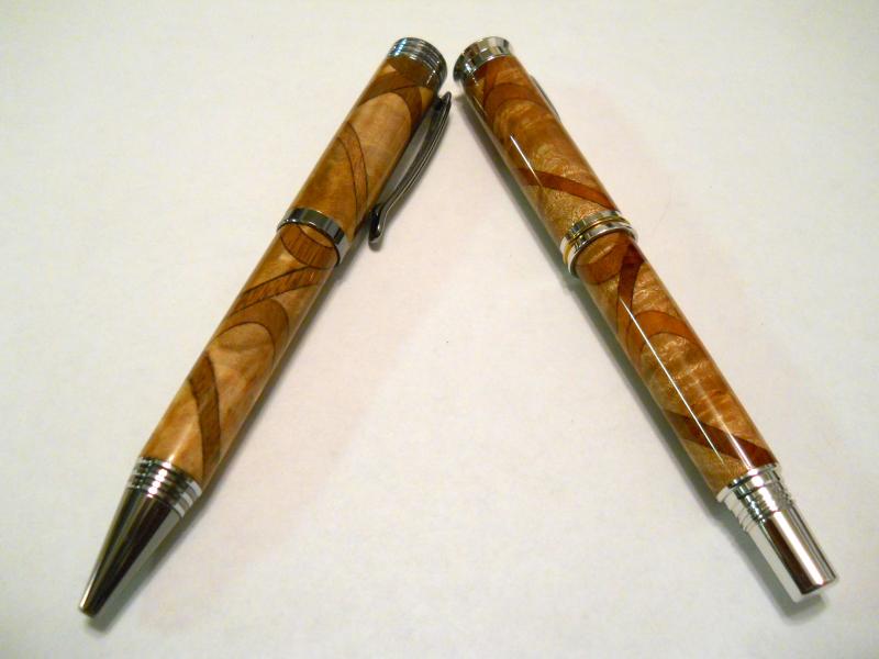

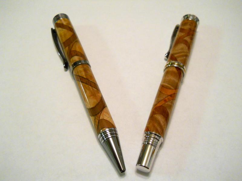

Here are a couple of twisted ladder segmented pens.A Myrtlewood/Walnut Duke,and a Oak burl/Redwood burl Jr.Retro.Not the easiest to turn or finish,lots of skew in scraper mode with these.C&c welcome.

Those look super! Could you tell us how that's done?
I've never seen that before,really cool looking.

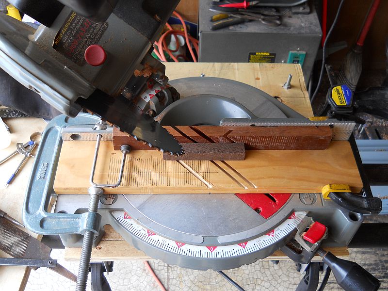

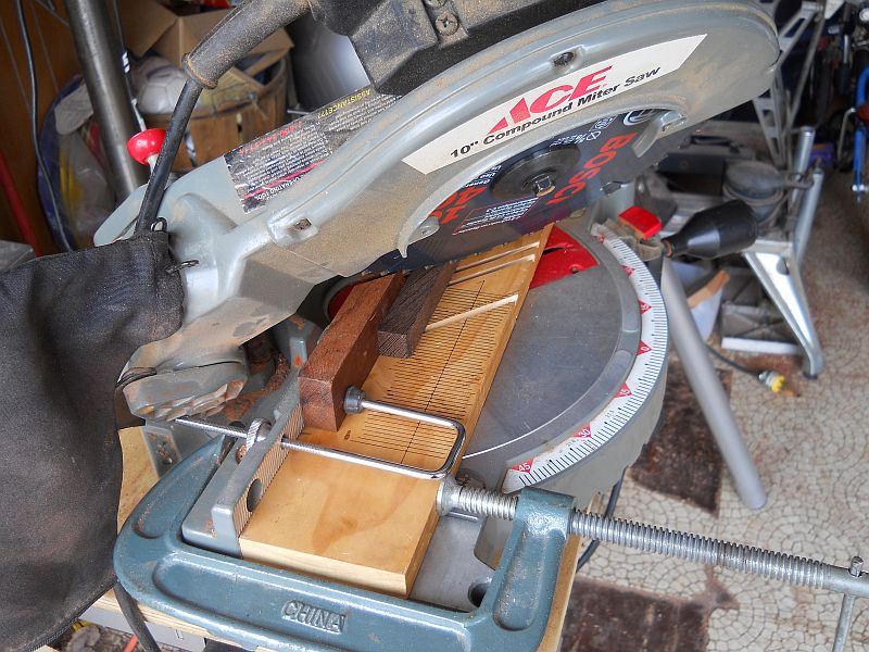

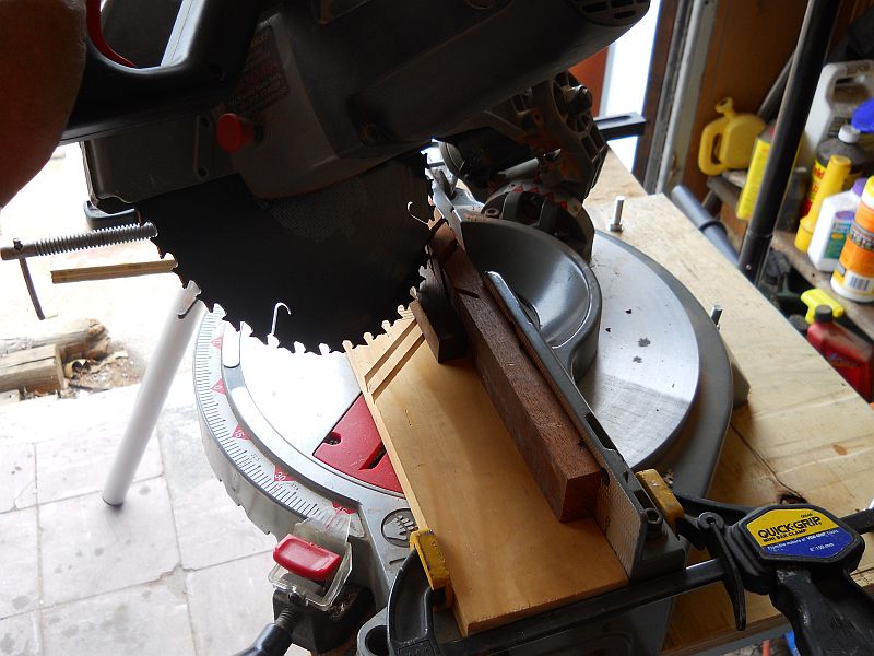

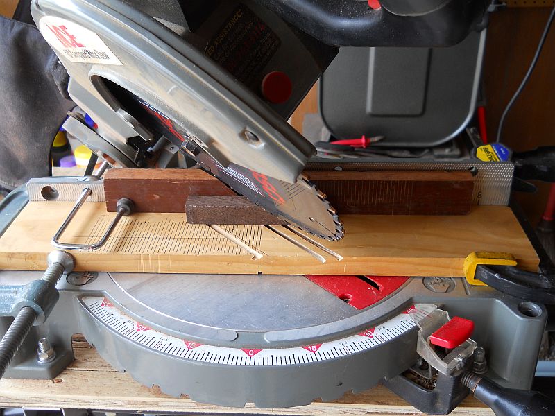

Here is a look at my current setup for making these blanks.Anyone got an idea on how to hold the blanks?I'm thinking that I may just have to remove the stock fence completely and build new.
randyrls
Feb 2, 2006
4,830
Harrisburg, PA 17112
Dale; Do you have a band saw or table saw?
If not, take a look at this jig I made some time ago for my TS. The hold-down could be adapted to the miter saw. If it clamped on both sides of the saw cut, both the cut and off-cut would be held without your pinkies close to the blade.
http://content.penturners.org/library/tools_and_jigs/celticknotjig.pdf
Dale Lynch
Dec 12, 2011
1,819
Hastings,NE
Yes I do,2 bandsaws and a tablesaw.1 bandsaw keeps throwing the lower tire off while the other needs a new motor.The table saw has soo much runout even Magoo could see it without measuring.
I like the idea of clamping it from both sides,just not sure how to go about doing it.The blade path is a large sweeping arc which is the the trouble I'm having.The underside of the blade is really shallow while the other side has the motor that gets in the way as well.
I think low profile hold downs is the way to go with a dedicated fence for that angle.I've seen the T track and holdown packages offered by rockler for the TS and DP.I wonder if they could be used on a mitersaw?If so then the next obstacle would be to figure out how to cut a T track slot accurate enough with the tools stated previously.
Dammit,I hate having a lack of ingenuity.
Thanks for the tips,at least it will get me thinking.
