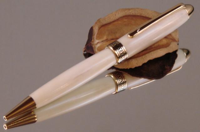

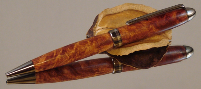

Here are a couple of Euros I turned late this evening. I'm sure that Ed4copies would have liked to find antler this white. The first is whitetail deer antler polished to 12k mm and finished with ca/blo. Titanium gold hardware. The second is amboyna with blk titanium same finish. All comments welcome.
