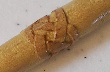

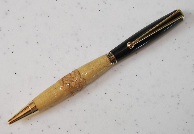

Here is a pen I hand carved with an exacto knife. It is a slimline. Just add a little bit of bulge in the center and taper it down to the bushings.

That is a nifty knot pen Bruce, I like it!

Make sure you show him the ends of the pen to see how much material he has to work with. I carved mine before finishing and assembling. You may want to have your friend carve them and then give them back to you for finishing and assembling. FWIW.
