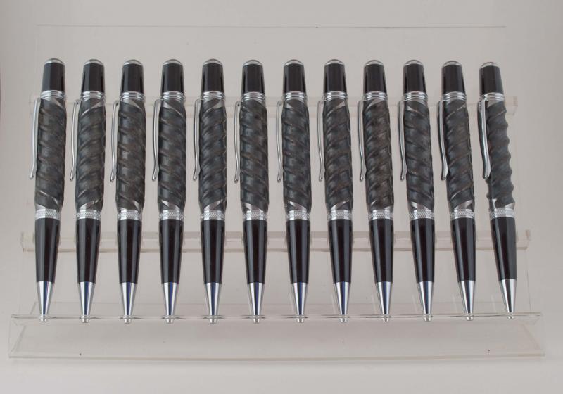

Local Iron Workers Union asked for a dozen re-bar pens. Made from #4 re-bar, tubeless design, drilled and reamed the re-bar to be exact fit like a Sierra tube.

The thought of a re-bar pen didn't do much for me until I clicked on the picture and saw them ..... WOW! they really go great matched with that kit too! Well done!

Look neat! Really a fitting design for the iron workers.
Do you coat the rebar with something ?
Thanks, per their request, they are not coated or seriously wire brushed. I filled a Tupperware container with sand and blanks and put it in the lathe at 250 RPM for an hour to get the worst of the rust off, then hand brushed a few spots.
For the ones I make for non Iron Workers, I power wire brush and coat with lacquer.

How much do they weigh? Did you use a particular/special drill bit to drill them?
They weigh 52g
Drilling is a bit of a trick question!
I picked up one of those boxes of several twist drill in each of various sizes on sale at Woodcraft. Drilled one pass at 1/4" and one pass at 3/8" then the trick, a 0.391" Chucking Reamer that drills a perfect 0.391" hole which is the I.D. of a Sierra tube.
For the twist drills, I used each bit for a few blanks and set it aside for sharpening some day when I get a Drill Doctor.
As the Chucking Reamer was only removing a few thousandths, I did not worry about it going dull on me. This reamer has over 3 dozen re-bar pens so far and still appears fine.

Wonderful pens! I have to cut rebar from time to time and find that one cut works fine while the next cut may take three or more blades. I do not envy the work in trying to drill that much rebar. Congratulations of a job well done!

Nice job and great idea. If you had a way of putting a local number on ther it would even be better. Wonder how a decal would hold up on the finial of the pen. Can I ask what you are getting for them???

I use bi-metal blades and have yet to break one, while my original blade broke early on.
Drilling was actually not that bad, I did it assembly line style. I had 18 blanks ready and drilled 1/4" on all of them, tossing the bit in the sharpen pile every 4 or 5 blanks. Then went to 3/8" and did 6 or 7 before swapping bits. The worst part was actually keeping the work area clean enough to work safely and accurately.
I still have 6 or so blanks to ream 0.391 then turn tapers on.
