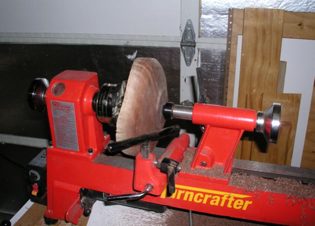

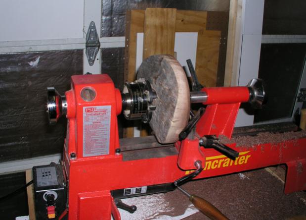

For those of you who have laid awake at night wondering "Can I turn a 9" natural edge bowl on a Turncrafter Pro VS Lathe?" The answer is.....eventually. There seems to be a thermistor in line that shuts down the lathe if it gets too hot. So you have to let it sit for bit and cool off. I'm still trying to rough out the bottom. This is also my first bowl. So far I'm scared to death of the chisel hitting me in the face. I'll post once I've finished what ever it will end up being.

With the tail stock being so close, you can't really turn it properly. I ended up standing on the other side of the lathe to do some of the turning.

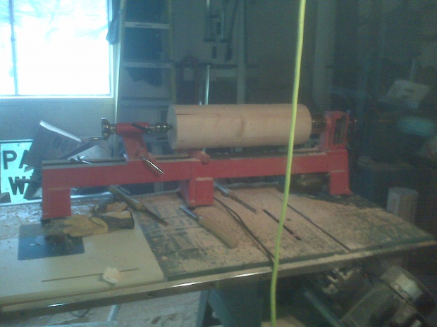

Yea I started turning bowl and other stuff on my little lathe too. It should would be nice to have more power as I can easily stall my lathe, even with a freshly sharpened tool.
You can go big on these lathes... it just takes time.

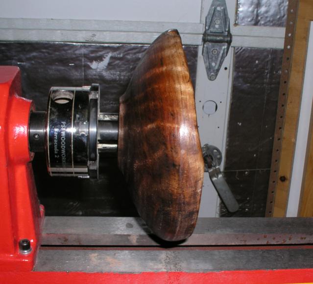

Yes, the lathe danced around quite a bit. Got a little exciting until I removed some to the mass.
The middle wasn't too bad. The bowl is fairly shallow. Unfortunately, I'm a one chisel man right now. I do all my turning with a skewchi (sp?) gouge.

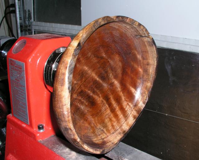

Here is the final shape with sanding sealer. The outer edges of the wood were pretty pithy so this will be my learning piece. I'll post a final pic when it is done.
Thanks all for the encouragement and advice.

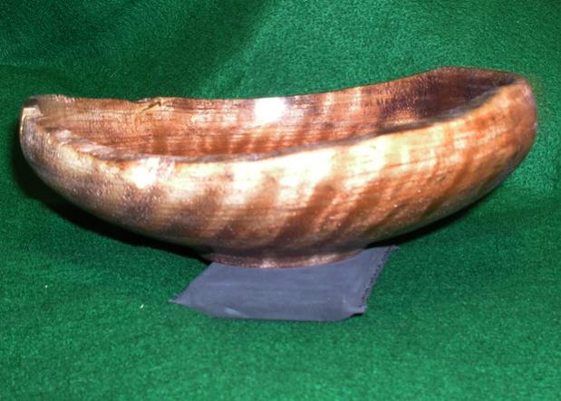

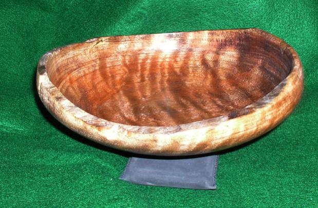

Here is what I ended up with. It's final diameter ended up being about 8". A lot of really good lessons learned. Thanks to dvoigts picture of his lathe with the bed extensions it clicked that I can remove the tailstock altogether and turn properly. The walls are a little thick and there are a few rough spots I just couldn't get rid of. All and all I'm happy with my first bowl. Please give any advice for improvement. I have thick skin.

W.Y.
Aug 10, 2008
1,656
BC, Canada
Nice try at your first NE bowl .
I have been trying to figure out why the shape of it isn't quite the same as most NE bowls that are more oval shape than yours and still have the Natural Edge bark on them. It must have had something to do with the particular piece of wood you are using.
This photo shows one of mine at the back left
and this one that sold for $69.00 last summer had a turned pedestal base on it but the photography was real bad on this one. It was actually the same nice color as the other one. . I learned on that one to not take pictures outside in sunlight. It sold before I got a chance to take a better picture.
Nate Davey
Jan 17, 2010
120
Fayetteville, NC
William,
The piece of wood I started out with was a fairly thin slab off the side of a very large tree, do didn't have the curvature. Thanks for the comments and beautiful job on your bowls. That is the standard I am aspiring to.
