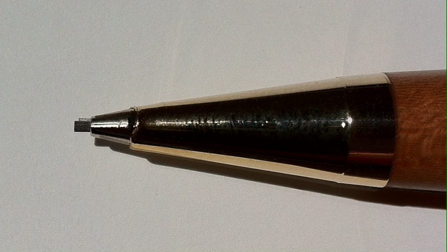

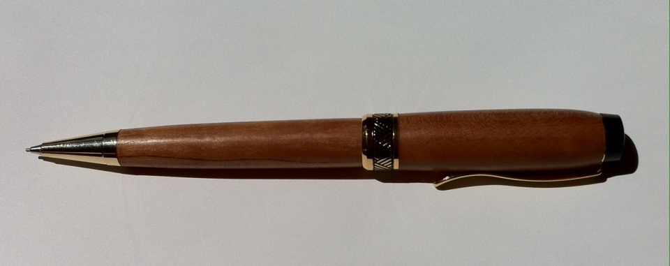

I had a request for a .9 pencil in a Mont Blanc style. The problem was finding a .9 insert. Ed from Exoticblanks.com came through for me as he has started carrying them. Then to find a kit. I tried the 8mm European Roundtop from Berea but the insert would not fit the center connector. Then I tried the Perfect Fit Convertible. Center connector was fine after I trimmed the small flange off the pencil insert. The next problem was that the .9 insert would not fit the nib. I modified a 9/64 drill bit by grinding a taper with a Dremel while the drill press turned the bit. I then proceeded to drill out the nib. Test fitting the insert in the nib periodically helps in not drilling too far. The nib does get rather thin so a better method of holding the nib centered would result in a better finished product. I've only made one so far but the results were pretty good.

Using the above as a guide, it took me a little less than half an hour to do the first conversion. The .9mm Schmidt mech (which we do have) will fit into the Perfect Fit, with minor changes to the length of the mechanism.
I also drilled out the nib and made the shoulder farther down---this may not have been necessary, as the real problem was the shoulder on the pencil insert. That DOES have to be removed for the transmission to screw back in place.
When you are finished, the transmission will depress the top of the insert, allowing the lead to advance, when the "pen" is in the extended position. When in the "withdrawn" position, the pen transmission is not engaging the pencil mech, so everything writes normally.

Ed - you said you shortened the .9 insert and removed some of the shoulder from the insert? I only drilled the nib and removed the flange from the mechanism. How did you go about modifying the shoulder of the mechanism?
