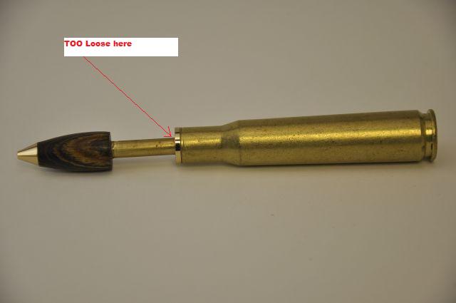

Thanks for the response guys, Heres a pic showing where It Is too loose a fit.....that brass tube gets pushed Into the nylon sleeve In the Shell

It should be loose at the beginning but tighten up in the brass tube glued in the nylon, this happens just before it is pushed all the way in. Only the trans. will tighten up in the brass tube glued in the nylon, not the tube you put in the nib. For this all to happen the trans. must be installed in the nib tube first to the correct depth then slide it all in the nylon. It should be loose where you are pointing on your picture. It should tighten up at the end of the push, on the trans. Do you have a brass tube glued in the fineal end of the nylon. I know there is no fineal on this but I mean that end. This should have been put in by the factory? This is only about half the length of the nylon. It should not hit the tube you put in the nib.Hope this helps. RichB

the transmission was not reaching the brass tube in the plastic sleave:eek:
so I CA glued a small pc of 7mm tube In the sleave, and I will give that a try
Rich Thanks,That helped me understand how this pen worked
Like I said above the trans never went into the tube, my wood Is 2" maybe too long, but anyway the little piece of 7mm tube I added in there worked....thanks all for chimming In:bananen_smilies026:
