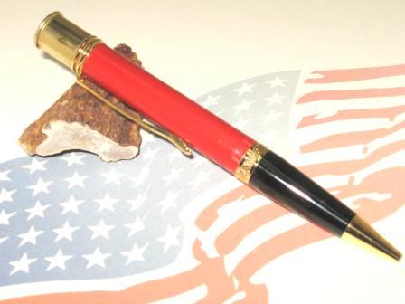

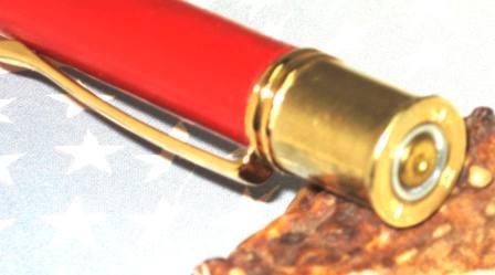

Does not involve turning but it turned out sort of interesting. Used a 410 shell with a Wall Street 2 kit from Woodcraft.
Comments welcome. Thanks for looking.

Instructions on the 410 pen
Sorry I`m so late with this.....Life stuff you know. But here goes.
You will need one 3 in. spent 410 shell with long brass and 1 wall st. 2 pen kit.
The first step is to remove the brass from the shell. I did this wit an exacto knife.
I carefully cut around the brass making sure it was cut square and neat.
Next you need to remove the excess plastic along with a portion of the cap that you can see in the brass. I did this with a 7/16 drill bit making sure not to damage the brass. This step is necessary to ensure the pen length is proper.
The next step is to alter the clip assembly.First knock out the finial and remove the black sleeve. Next you need to remove about 3/16 to 1/4 in. from the top portion of the clip assembly to make sure the brass will fit properly. It is best to test fit the brass on the clip assembly at this time to ensure proper fit. You may need to remove more if the fit is off. Once all fits nicely epoxy the brass on the clip assembly and sit aside to cure.
Now move to the body of the pen. Take the plastic portion of the shell and put the brass tube from the kit in the shell body.Next trim the plastic to the exact length of the brass tube. Trim the crimped end of the plastic.
When this is done glue the tube in the plastic portion.( I used CA ).
when all the parts are cured or set up press the clip assembly in the shell body making sure the crimped end is toward the nib end of the pen.
Then assemble the rest as usual. Good luck and post a photo.
If you have questions let me know.

Great job, Perry!
If you want to sell these, there is a BIG market for Winchester AA .410s fairly near you.
There are two HUGE skeet complexes in the Metro area. .410 competition is what separates champions from shooters. They all shoot AA.
I think you got yourself a nice little niche market with these.
