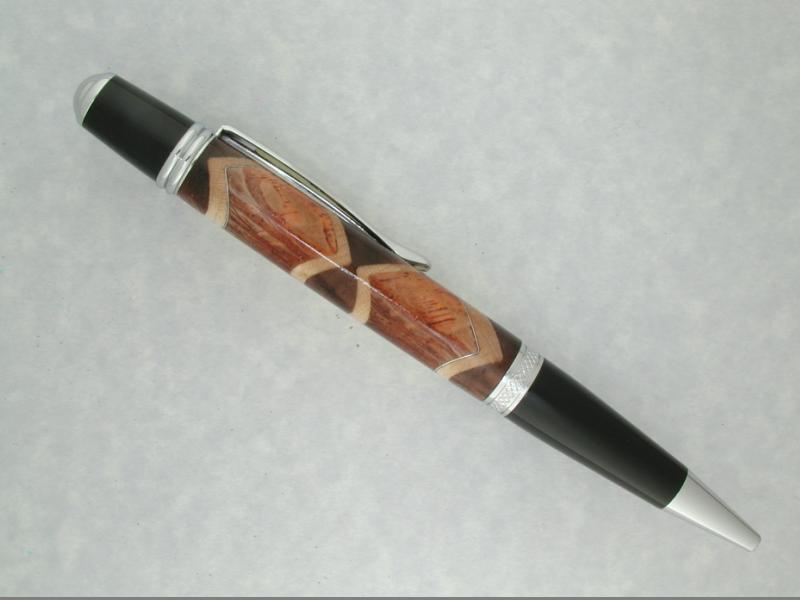

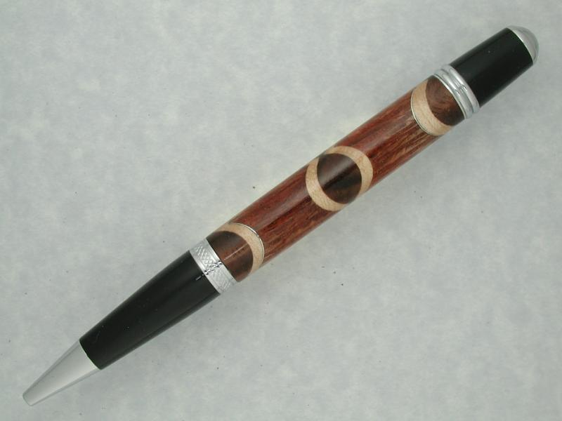

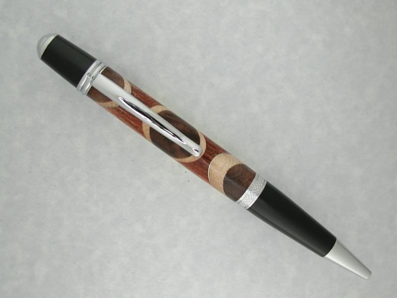

Made the blank then cut off one edge and drilled down the center of the remaining piece. This kind of gives an abstract design to the remaining blank. The material is Walnut, Maple, Lacewood and aluminum. The link at the end will go to a 750 kb movie showing a 360 degree view of the blank on the lathe.
This is the link to the 360 view movie.
Chuckie

Charles, if the blank looked something like this:
The cut would be along the verticle broken line. The same thing could be accomplished by drilling off the center of the blank.
Hope that helps.
