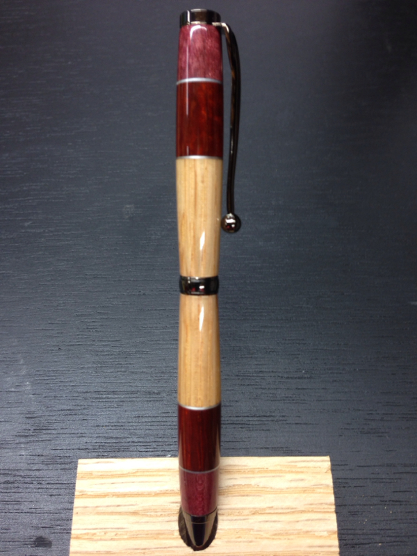

Still digging in the scrap bin to learn this craft. Red Oak, Padauk, and Purpleheart separated by .019 aluminum on a gun metal component set with a CA finish. I think I might start trying some angle cuts next. Thanks for looking. Comments and suggestions welcomed.

A Nice one Chris,
Great Fit and Finish.
Love Seperators in segmented pens where appropriate.
Aluminium is a great seperator, as are Guitar Picks, Formica. and I have been told, also Credit Cards.
I cannot vouch for the last one, as I haven't been able to pry any from my Wife.
Look forward to your Angled One next.

Brian, thanks for the idea! I hadn't heard of using guitar picks but with the colors that they come in that could be very interesting. Thanks for your comments.

Awesome mate, I really like it. Is it hard to turn the aluminium?
Hi Sean,
It is easy to turn, with normal woodturning tools.
Actually a bit easier that a lot of Acacia's, Mulga etc. from your "Neck of the Woods"
Just treat it the same as wood.
A suggestion is to use a can containing an Adult Beverage, after you have emptied it in the traditional Kalgoolie manner, or a Soft Drink, will do as a poor substitute, inparticular with the tempretures you get out there.
Cut it carefully with a knife, or scissors (not your wifes, or Surgical Dressing ones) into strips, and glue it between your joints, and Clamp.
be cautious when drilling, take it a little easy when going through the Aluminium, it can at times tend to grab hold on the drill bit.
Trim any excess from the blank before turning so that there is no flaying metal to cause any trauma.
Have Fun.
Brian.
Yeah, what Brian said.
On this pen I used .019 thick aluminum which is considerably thicker than a adult beverage can, which are generally in the .003 - .005 thickness range. I couldn't feel a difference in the tool when turning a blank using the can but definitely could feel it with the thicker pieces. :beer:

Very nicely done! The woods really compliment each other for a very eye catching pen and the aluminum creates a clear break from wood to wood. Something to be proud of certainly.
Where did you source the thicker aluminum from? I know you can buy shim stock in a variety of thicknesses and in brass as well.

Thank you. The aluminum was purchased at Home Depot in the hardware dept. 12"x12" piece was $7.49.
