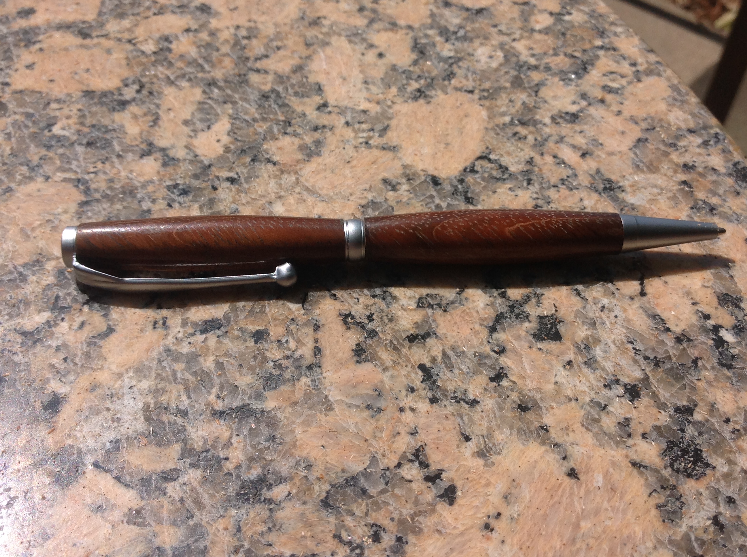

2nd Pen
See more from Aces-High
Dehn0045
Mar 19, 2017
1,533
US
Very nice slim you got there Jason, great work. Calipers can be helpful when you don't have just the right bushings, I'd recommend getting a set as they have been helpful for various things with my penturning.
Aug 13, 2016
1,460
Surprise, Arizona
Very good for your second pen, slims are harder than many (most) other kits I've made. I agree with getting a caliper. A good digital vernier will allow you to get far more accurate than the bushings. Thanks to the advice from experienced members, I've started turning it close to the bushings on a mandrel then finishing between centers without bushings, stopping frequently to measure with the caliper. My accuracy soared when I made the switch, and I never had the out of round issues that I sometimes got using a mandrel. It takes a little longer, but the results can't be beat.
OZturner
Aug 5, 2013
6,662
Sydney. NSW. Australia
Nice Pen Jason.
Nice profile, though as you mentioned, some of the Diameters, at the Transitions, are a little "Off".
Bushes will be a Great Help, as will a pair of Vernier Calipers.
Please keep this Pen, and use it as a Gauge, and Measure Just as to how much you have Progressed, over the Coming Weeks, Months and Years.
I look forward to seeing your Future Pens.
Congratulations,
Brian.
