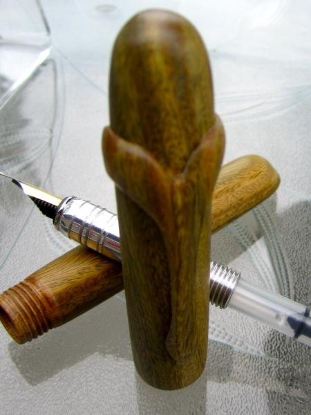

Well I decided that I had not self punished enough with the first attempt
at a pen sans kit.
On my second try I thought I'd try wood ( plenty of that around my garage)
because, well the first one sort of ate up all my spare blanks.
as this is a whole new door for me to go out
C&C welcome

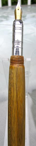

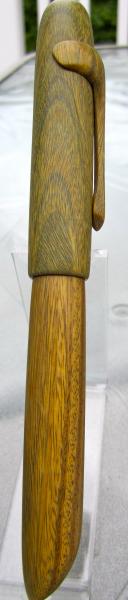

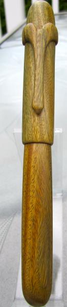

The wood is Lignum Vitie ( I think that's how it's spelled ) and the threading was sort
of an experiment, after turning the blank to size I used a razor knife to score the wood
all the way around than soaked it in thin CA and let it soak in a while ( a minute or so )
and than hit it with accelerant. and started to tap, after a few rounds I would repeat the process,I worked the process out on a pine dowel so I figured it would work on this stuff.
