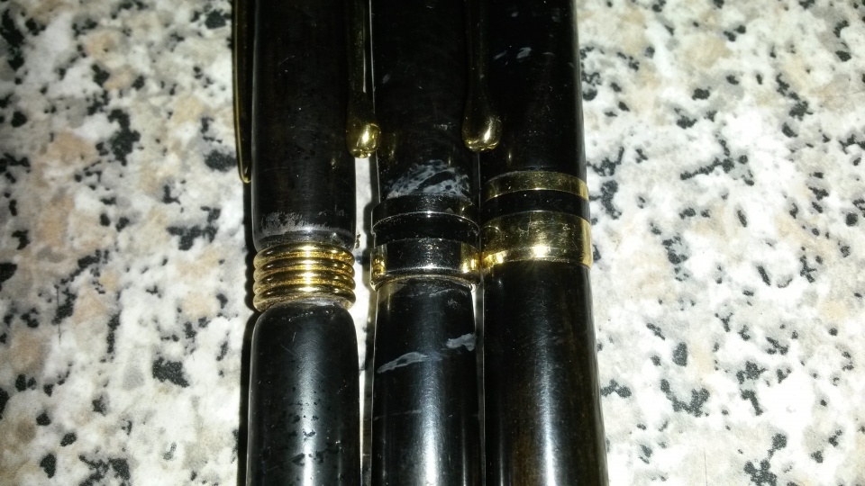

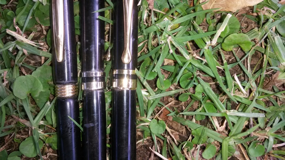

I purchased 25 kits with a life long warrenty on the 24 kt gold plating in November last year.I specially made a set ( pencil, pen and fountain pen) for myself to use and show off to friends and potential customers.Unfortunately I have found that now (after five months ) the gold plating is clearly showing wear. Is this a common problem? Fortunately I have not sold any yet. I gave treid to contact the supplier via their webpage but they simply dont reply.
I dont want to mention any names but I think it is common knowledge who sells these kits.I shall appreciate other members comments.
I have added two photos. My photografical skils are deffinately not the best, but if you look carefully you wil notice the wear on the middel pen.

The only guarantee on 24kt gold is that it WILL wear off! If you want the look of gold then purchase the Ti-gold plated kits. In the meantime try returning the unused kits. Any decent vendor will stand behind their product.

While we happily guarantee the pens we make and sell against this sort of wear, we've only had a few actually returned. This was several years ago and the problem was related to the black finish on some Wall Street II kits. These were easy fixes, obviously, and were clearly related to the pens taking a serious beating.
While I would still eat the repairs that were necessitated by such rough treatment, I don't think that it is unreasonable for an abused pen to suffer some plating damage. This brings us back to the OP's pictures as those pens seem to have been used HARD.
