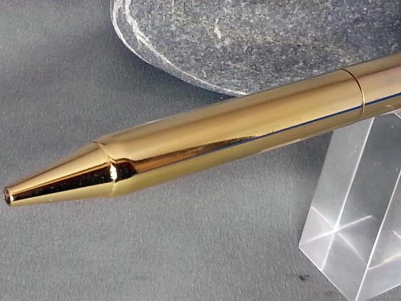

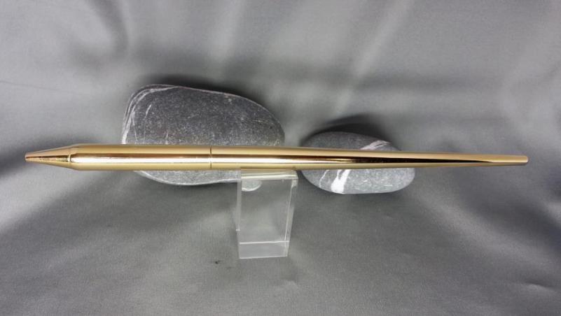

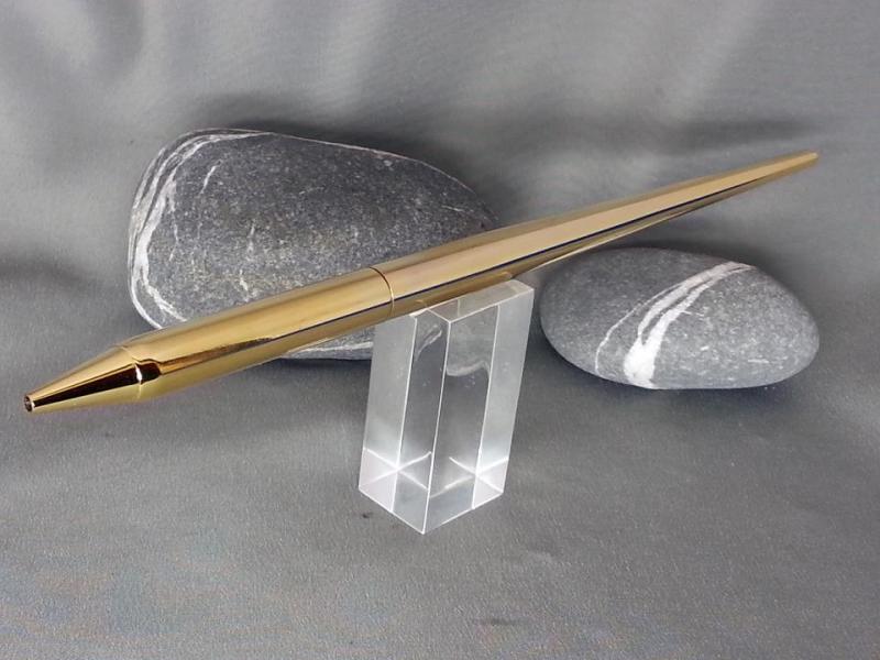

‎21st Century Quill in 24ct gold
A pen crafted from brass which has then been plated in 24ct gold
a very long design, modelled on a quill. A truely luxurious pen which suits any executive desk or for those who truely appreciate the use of a fine pen.
the front section is one piece, nib inclusive.

Absolutely beautiful. You have way too much time on your hands.
Could you etch some lines on the body to simulate the quill lines?
Just beautiful! Almost looks liquid!
Theres a trick to that as ive found.
I chrome plate the piece first giving it that slick mirror like finish, and then give it a brush coat of 24ct gold plating. the chrome still shines through, giving you that lusterous liquid shine
