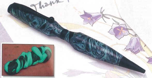

I thought of a project that would involve everyone and isn't as messy as the casting method. I found an article in issue #2 of Woodturning Design "Polymer Clay Pens". We could each bring a different color or we can all chip in and buy some before the meeting. The material can be bought from Micheals. This is just one idea, any others?
Please also post what food item(s) you can bring for lunch.
Larry

Elizabeth had this to say about curing time:
I've never used the ice-dunking technique that Ed cites in the articles; some others have reported it causes brittleness – however, for class it might speed up the curing process. The clay is very fragile after it comes out from the oven and I find letting them air cool works best for me
Additionally, I discovered that sometimes the bond between the cured polymer clay (PC) and the brass tube can fail, and the tube will spin while turning. However, if I apply a very thin coating of liquid Sculpey or the "Sculpey Bake & Bond" to the tube before wrapping it with the sheet of PC and then baking, no failures.
Do you have any of these? If not, I can stop by Michaels tonight.

I don't have any of the Sculpey Bake and Bond. I find that letting it cool out of the oven works best. The finishing of the pen is done with sanding and not much with tools, unless you can use a skew.
