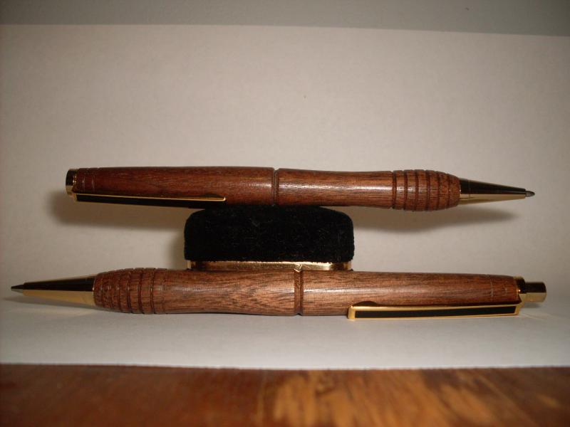

I make single barrel pencils by cutting the blank to length then gluing the tubes into each end. This way you can still put the pencil on a mandrel for turning. My daily carry is a one piece pencil made this way from black walnut. It was the the first set I made. The center grove on the pencil is cosmetic to match the pen.
