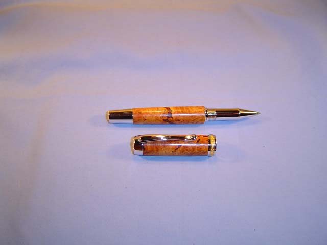

Well after seeing all the great pens posted in pen in the hat. I though it was about time i made more than slims.
Didnt know what this would look like so all i did was go bushing to bushing. I'm going to try and make a bunch of different ones so i can try them out and keep them in my display bag to show customers.
If i were to sell one of these, i would add a pen stand or rest, this would also serve as a pillow for the cap while in use.

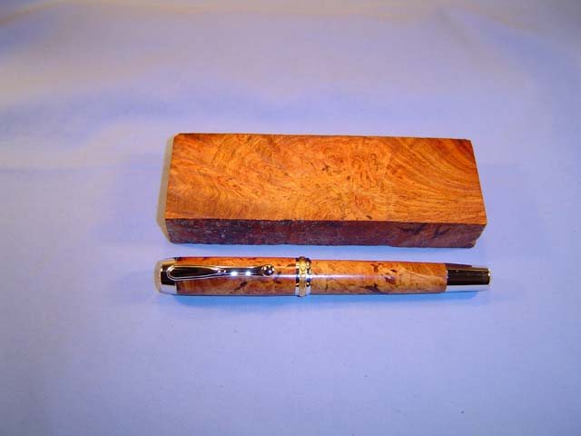

Took me a while to figure out what wood to use with Rhodium. Solid dark colors didnt look good to me, i think i like how this wood looks. comments welcome.
My camera is fighting with me again....

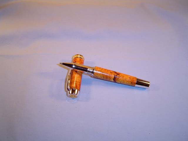

Statesman, Rhodium with 22k gold trim. Wood is Afzelia Burl
I experimented with the finish. The wood was waxed and pretty dry.
As i turned i used tung oil everyonce in a while to give the wood a drink. After turning, tung oil, micro mesh sanding, a couple coats
of hut friction. Then a hand full of shavings to burnish the outside.
An finally a few more coats of friction. Didnt use ca, trying to keep the feel of the wood.

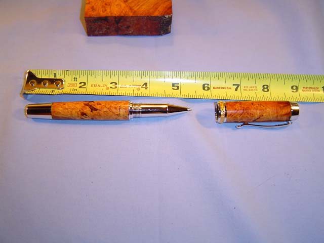

This is one BIG pen

thanks for the comments.
Bill whats your fav burl ??
Frank as far as the friction holding up, we'll see.
I was going to use just tung oil, but didnt.
Hmm mabey i should ask Lou how his TSW is on bare wood.
thanks ....pete

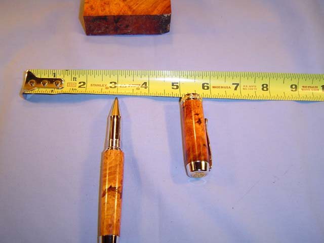

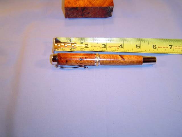

Nice looking pens; but your photography doesn't show them off to their best effect. Try shooting them a little closer or take the existing photos, crop the useless border areas and post at 625 pixels wide. The tape detracts from the pictures IMO. If you want to indicate scale try something diifferent.

Why that's a beautiful start to the larger pens. So what's the problem turning bushing to bushing? I think it looks great! You don't have to have big curves on every pen. Great choice of wood and kit. I love the Statesman. The finish from the picture looks good, I too hope it stands the test of time. [8D]
