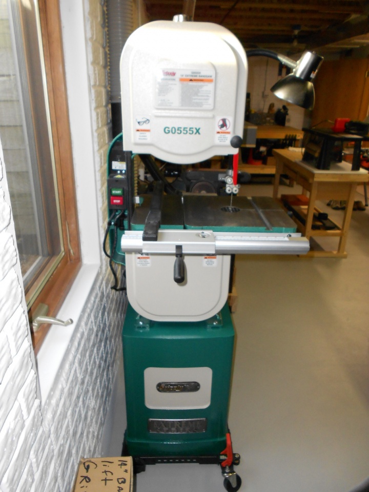

Dalepenkala
Dec 11, 2012
1,642
Auburn, Michigan
Agreed! This was before I put in the 6" riser! Awesome saw for the money!
