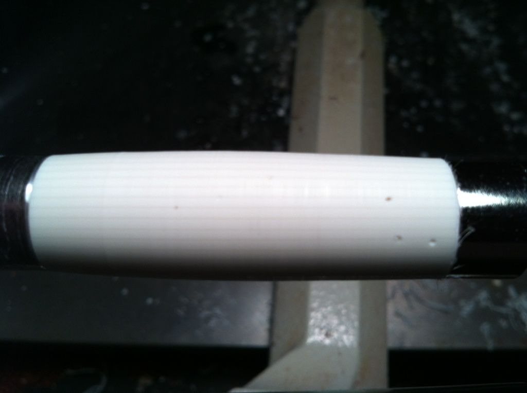

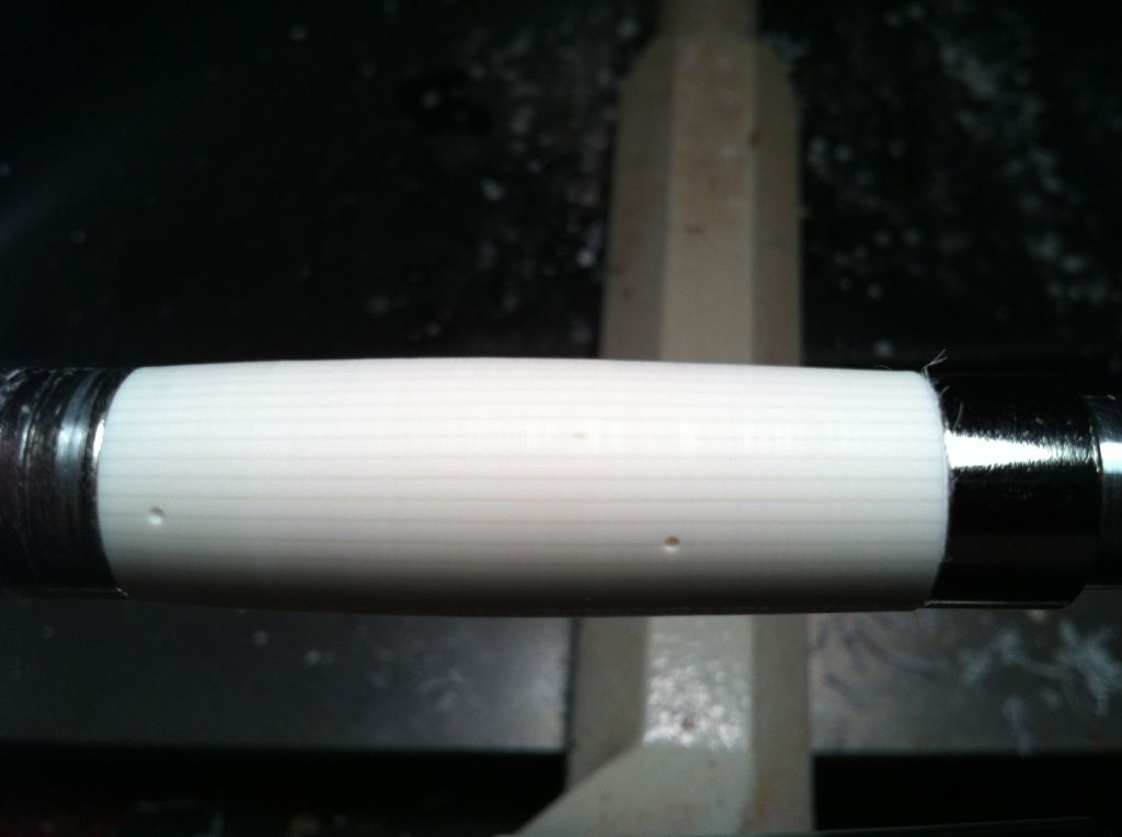

This is my first time turning casein. Okay, second if you include the cracked blank from drilling too fast, but I digress.
I am trying to make a cape for a Jr. Gent, and this is the second attempt, cut from a different blank than the first. I did not get pics of the first, but there were WAAAY more holes.
This second blank was hole free until I got farther into the blank.
Is this normal? I did a search and read a dozen threads about casein but they all dealt with chip out from tools not being sharp.
I can shave my legs with my skew. I'm OCD with sharpening. I went as slow as possible. I could have sanded with MM and made faster progress.
Any help would be greatly appreciated.
First are these Casein or alternative Casein, the lines look too straight to be Casein, which would mean that when in it was made it being a resin those are holes from the manufacturing.
I believe it's regular casein. I ordered some form CSUSA and Penn State. I'm in the garage now working, turning a THIRD blank for a different pen and I'm getting the same thing.
I just came in to look up my order info, and nothing says "alternative".
The description reads "Casein naturally derived from milk proteins".
Certainly look like air holes. I posted a couple of months ago about tiny pinholes in real casein that are dark once they get any sanding dust or CA inside. Did not have a problem with alt casein.
Then definitely holes during the manufacturing process, I would tell my supplier so that they would know and maybe pull from their inventory that batch and if one of the vendors on the IAP I'm sure they will replace them.
Exotics is the only source for alt casein. CSUSA and PSI both have casein, now.
Yes, I would say those are air bubbles. They are round. Turning mistakes are not likely to be round.
That's weird. It happened with two different sources. CSUSA and PSI. I'm turning the one from PSI right now and getting the same problem.:frown:
Well, I didn't know much about casein BEFORE ordering it, I just liked the look. Not that I know all that I do, I'll be ordering the alt. I just wish I could salvage these.
You have better than a 50-50 chance of getting a replacement from CSUSA. PSI may be a little more difficult. But there should not be bubbles in the casein.

Thanks for all the info! I'm going to try and email them both tonight, or call tomorrow. This kinda screwed me. I was supposed to have my first "show" type thing at my daughters school Friday. It's just a family fun night, as they call it, and they requested some vendors.

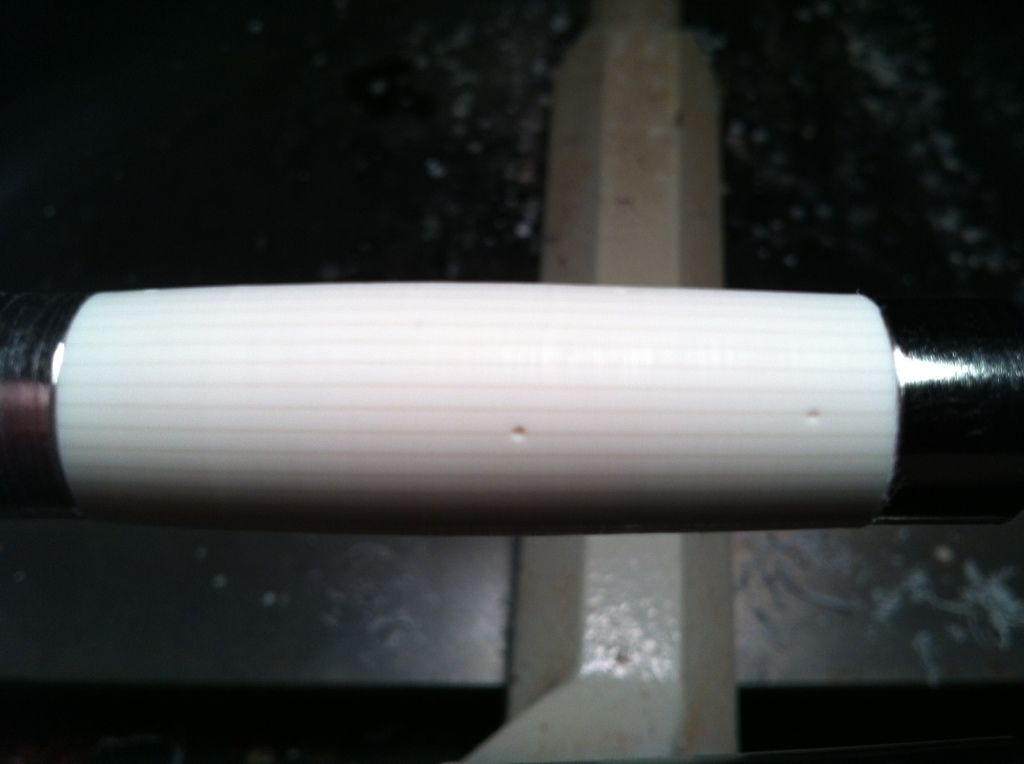

BTW, here's the last blank I had. Same thing, even worse.:at-wits-end:
Don't be surprised if they ask you to return the blank---I would.
I've never seen that in over ten years of selling casein. They SHOULD return it to the manufacturer so it does not happen again.

I JUST hung up with CSUSA. They are shipping out two replacement blanks tomorrow!:banana:
I offered to return the unused portion and the turned sections, or send pics and they didn't need either.
I guess I can't complain about that!

I have a few holes in the ends where they were cut as well. CSUSA at first was going to send me replacements, but they emailed back and said the rest of their stock appeared to have air holes as well.
I'm getting a refund that I'll use to order the alternate.
