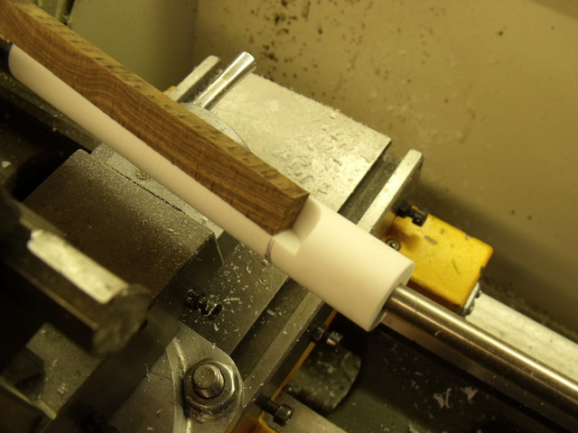

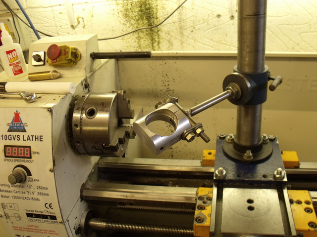

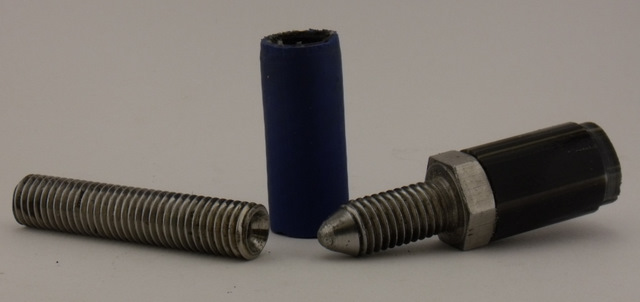

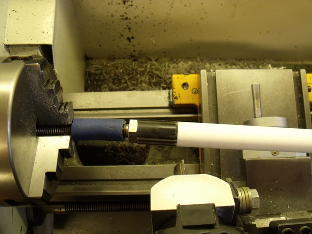

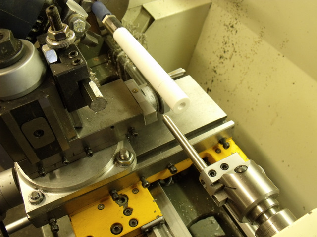

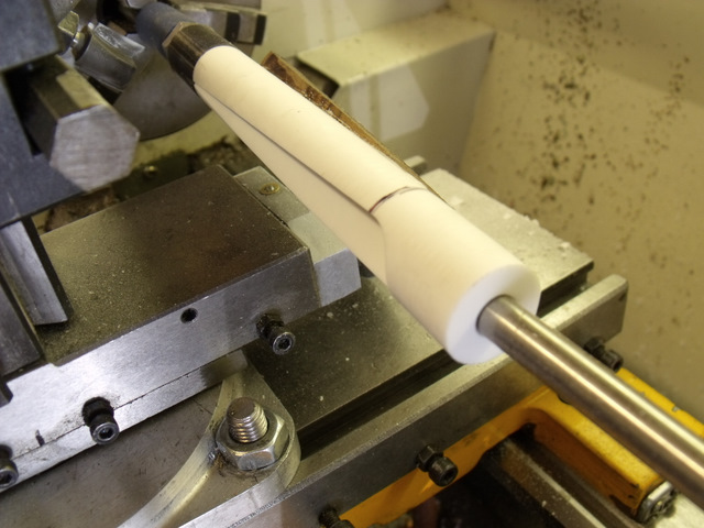

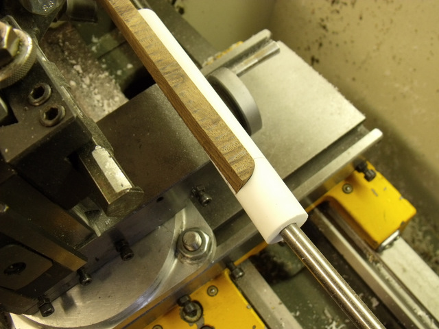

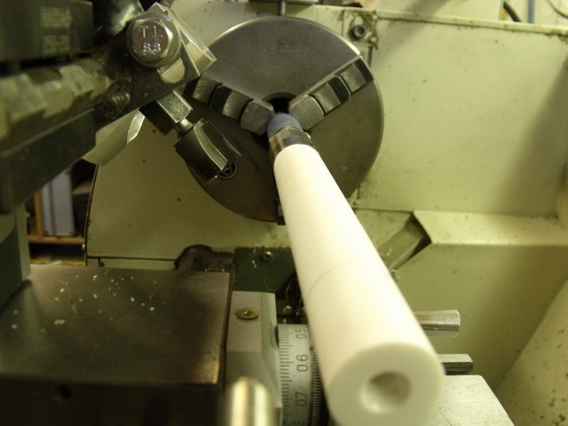

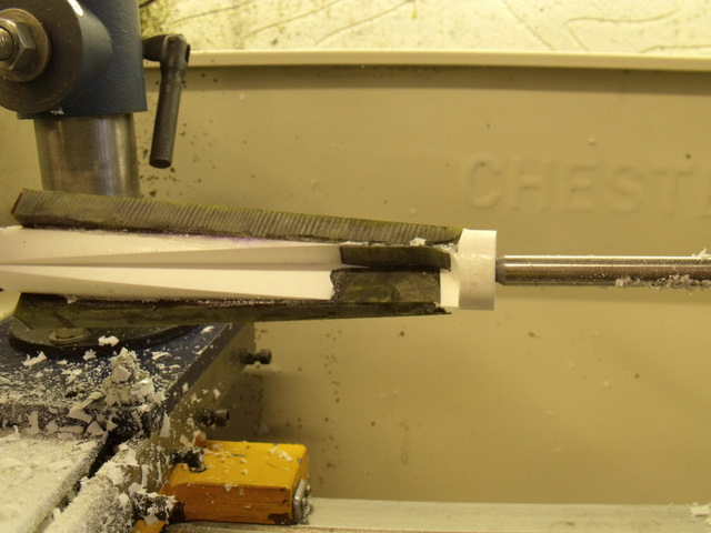

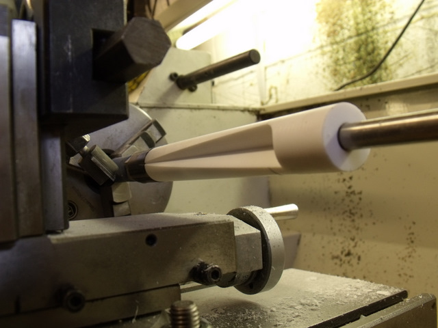

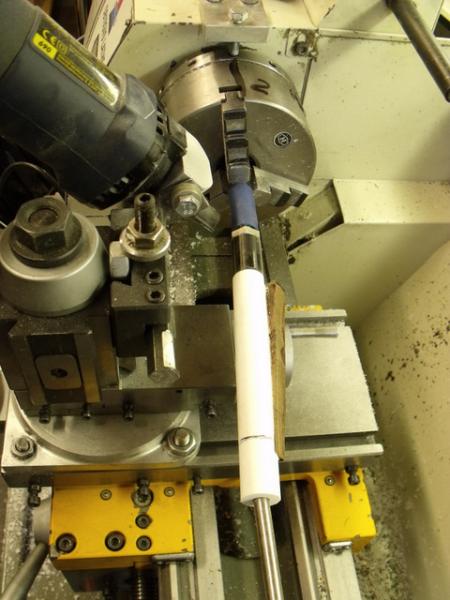

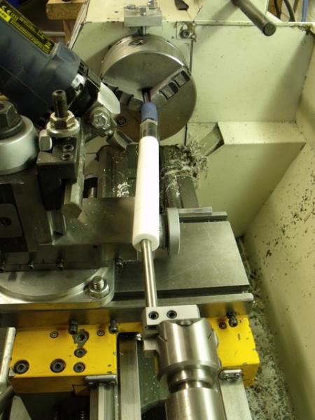

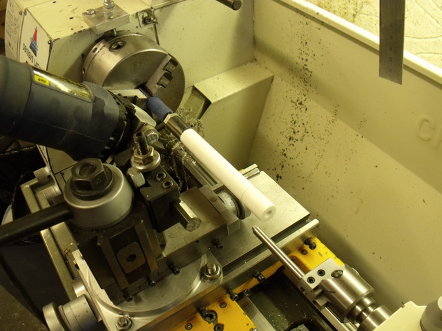

Hi all

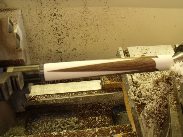

I've been playing in my toybox again :biggrin:

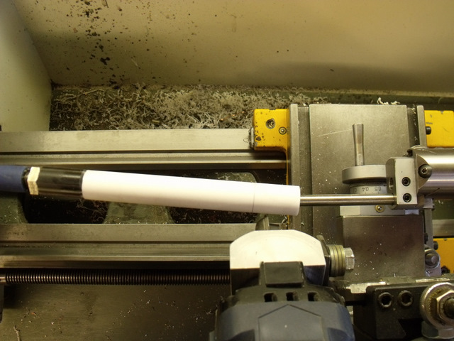

I've shown how I made these blanks with sharp points before, but I never really liked the 'ramp' method and think this method is much simpler and potentially far more accurate.
I think the pics are self explanitory, but there are a few points worth making. Instead of offsetting the tailstock ( a pain to reset ) I used a Boring Head with a pointed length of rod as a dead centre. The other end has a flexible joint that is nothing more than a bolt and a bit of high pressure hose.
Instead of me writing an essay, please just ask if you want clarification on something. :wink:

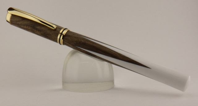

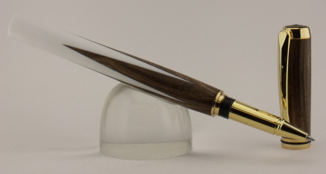

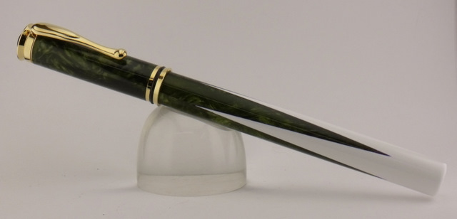

The end result here is a closed ended Baron II with white PR and Walnut
Hope you like and also that someone finds the pics useful:wink:

Thanks for the pictures. They all make perfect sense to me. I assume you index by the gears at the back of the spindle.
Pen looks good too!
Pete
Hans / Pete

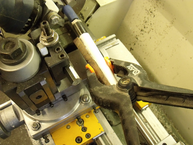

There are 4 flutes ( indexed off the chuck )
The white PR was CA'd to the sacrificial piece of PR that is also CA'd to the bolt. It's actually stupidly simple to ensure that both are perfectly aligned when glueing together, but it took me a while to figure out how:redface:

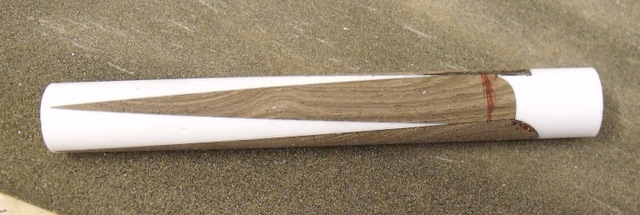

The pics are fully explanatory except for one thing for my feeble mind. I understand the recess on the drive end for the drive to fit, but where did all the extra white PR past the pointed end of the walnut come from?
This tut is very good and thanks so very much for taking the time and effort to produce it for us. That gorgeous pen makes me want to sell my first born and buy a good metal lathe. Any offers?
Charles
........... but where did all the extra white PR past the pointed end of the walnut come from?
:biggrin: LOL, it was there all the time:wink: Remember that the wood inserts are extremely tapered, so as the blank is turned down, they get shorter and thus reveal more of the white that was underneath them.:wink:

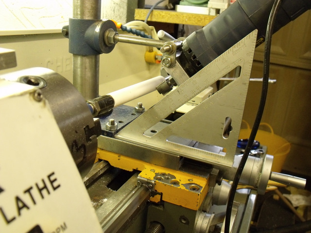

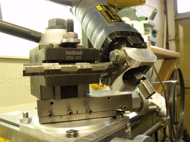

Skip do you have a picture of the holder used to hold the lamanate trimmer in your quick change tool post.??

Oh, my head hurts just looking at the pictures. :)
The pictures help understand your methods.. But its the thought of repositioning to exactly the right place that gives me headaches!

You wouldn't need a metal lathe George.
>The headstock end could be done with a spur drive and the blank end cross sawn to allow the wood to "tip" away from the normal axis of rotation.
>The tail end could be nothing more than a big spike, hose clamped to the side of your live centre or the side of the tailstock with shims to get the desired offset.
>The router held at the correct angle, in a plywood sled riding on the lathe bed with a stop to limit the travel.
>Since most lathes have basic indexing holes, locking the blank in the correct position is a given.
There, the rat skinned on a budget. If I ever decide to try if I will use much the same method as skiprat since I have a metal lathe.

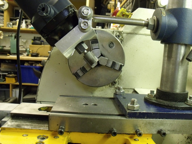

skiprat I saw the 3 jaw and didn't realize the chuck or backing plate was drilled. Even without, a four jaw would work. Come to think of it an independent four jaw chuck, depending on size could provide the offset too. :smile:
Pete
Lin

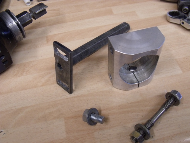

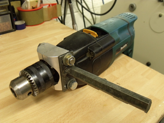

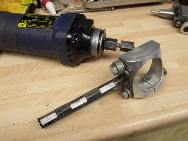

Sure Lin,
It's really very basic and something I cobbled up years ago. In some of the previous pics, you could see several washers on one of the bolts. This was pure laziness on my part. :redface: I have now just cut the bolt shorter.:biggrin:
The combination of the flats on the hex shaft and the slotted holes in the bracket allow for just about any angle. The big hole in the aluminium block is standard DIN pattern size, so many other machines can be clamped.
Of course, sometimes getting the cutter at the required height isn't always possible using either the QCTP or even the old toolpost. I have another contraption to hold the machine then but it still uses the same aluminium block.
The eagle eyed may have also seen that the compound ( or top ) slide is facing backwards in the previous pics. I swung it around just to give me a bit more room between the tool and the workpiece.
Lin
Sure Lin,
Perfect, Thanks a bunch Skip.
Lin.
Skip, I love your style! Rather than a 10 page step-by-step tutorial, you cut right to the chase with a few photos!
I've been wanting to make some sort of an adapter to hold either my dremel or foredom tool on my lathe. I actually made a holder but didn't like the results so tossed it out. Now, after looking at the photo below I realized that I could make good use of a block of aluminum I have and make a circular clamp as you did, one for my trim router and another for the dremel and foredom and all three could use the same mounting rod that would clamp into the tool holder.
It appears that you set your cutter to where it meets the blank at 45 degrees, right?

George, try LMS for those holders. I could be wrong but I think I've seen them there. But of course there is no fun in that, so here is Version Eleventyfour. It uses the pillar from an old drill press. I welded up the universal swivel arm ages ago. It can swing to absolutely ANY angle, but just takes a bit longer to set up.

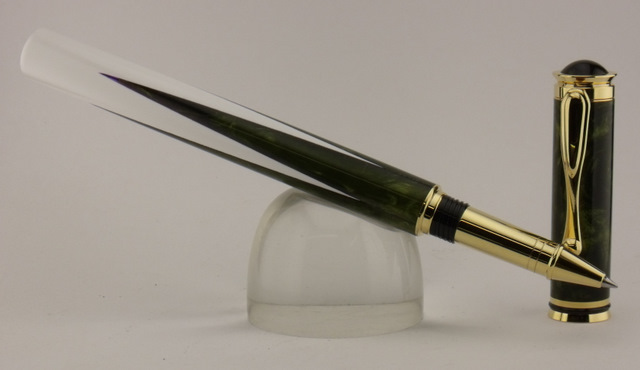

The end result here is a big dissapointment. Technically the pen is fine but:redface: Senility is setting in early and I forgot to paint the inside of the PR Avocado blank once I drilled it.
I painted the cap and I even painted the 4 pieces before I glued them into the white. But completely forgot to re-paint after drilling. It looks worse in real life than in the pic.

I did a similar thing as to Skips Pen, instead of using a metal lathe, I used my wood turning lathe that has a base for copying. The trimmer was set up with a V cutting router bit and a straight edge was clamped at an angle. I did make a tool that is adjustable that fits in the tailstock for offsetting work. The pen I did had the base, the V section then another V section with the same timber as the base. Can show pics if anyone wants.
