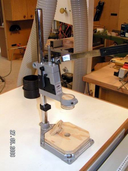

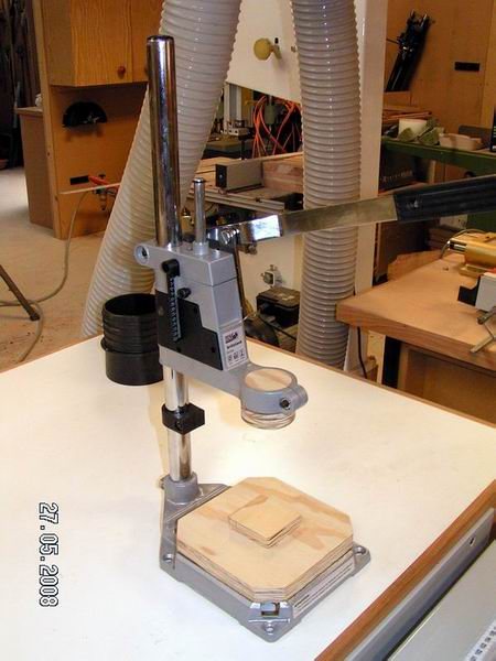

Charles, I had been looking at the Rockler pen press/vice, but found it a bit pricey. Also another forumite on the Oz forum bought one and wasn't totally sold on it.
I was in our local Aldi store the other day and they were selling drill press stands for hand held drills, for the grand total of $14.95!
Had a brain flash and decided they could be turned in to a vertical pen press, so I bought one and I did.

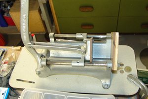

Hi Dale,
Here are a couple of pics of my "pen press". It's a potato wedger that I bought at a thrift store for $10.00. I glued a piece of masonite to a piece of plywood and mounted it where the blade would have been attached and also mounted another piece of masonite onto the "pusher" and Bingo a great pen press. You can buy the wedgers new at Northern Tool for about $40.00. About 50 times as sturdy as the real pen presses sold by PSI and everyone else.
