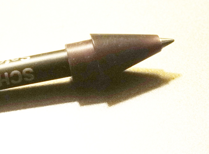

Here's one I did toady. Its a prototype for a roller ball nib. Finished piece weighs about 0.6 gms in wax, so in silver it will be about 6 grams or 1/5 ounce.

Bruce, did you turn this and if not explain the process, please.
For this one, I started with some round stock chucked in the lathe. I first drill a hole about .1" in diameter and about 1" deep and tested the fit of the tip portion of the refill. Then turned about 1" of the piece round to the widest final diameter. Next, turned the angle with a carbide scraper which leaves a pretty nice finish. Next using the scraper again, made the tenon. Since the end of this will have to fit the widest part of the refill which is about .240", I made the tenon about .340 which leaves a .050 wall thickness. If I wanted to make the piece a little lighter, I could have made this a little thinner, but I'll see how it feels when its in silver. Then I parted it off with an Xacto knife.
At this point, the hole in the back is still .1" and too small. Note that roller ball refills have a step before going to the widest dimension. Using incrementally thicker drill bits, by hand, I just reamed out the back to match the profile of the refill.
