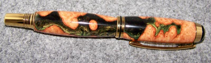

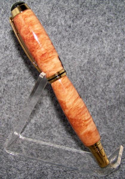

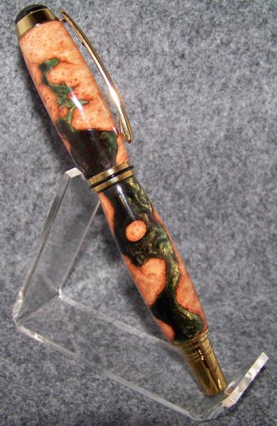

This pen was nothing more than a trial of my patience from the beginning. It was a pain in the rear to cast the burl blank, had a leak on the pressure pot (did get lucky with minimal air voids-filled with ca and went on), totally destroyed the 1st attempt, took forever to turn, had to redo the CA finish 3 times, and lastly....yes I know that the cap finial belongs to a Jr. Retro. HOW in the hell it got there I have no idea but I didn't notice till after I took these pics :redface: so I'll have to take the darn thing apart and turn an end peice. So after all this...please leave some happy thoughts on my pen. Thanks for looking and letting my vent!

Thanks! I guess I forgot to give the actual details of the pen huh? This one is brown mallee and I'm using silmar 41 for the resin. You really can't tell from the pics but his is by far the best finish I've done. There are absolutely NONE of those ity bity tiny scratches on this pen. I didn't even use the buffer this time. I did use brand new MM pads. So from now on I'm cleaning my MM every few pens to keep it from getting buildup on it bc I'm sure thats what causes those scratches everyone hates so much. I am a bit dissapointed that the resin is only on that one area but I had already made these before I read that post of yours (jeff powell) about using a typhoon bit to mangle up the burl more. I have 1 stick of this left that is red mallee and I might see if I can't destroy it later!
