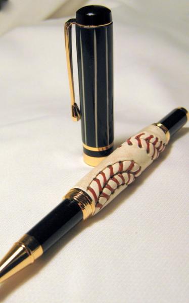

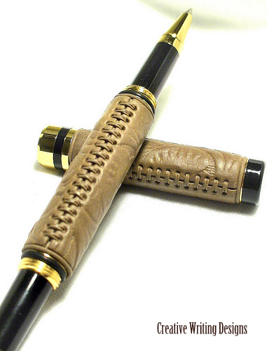

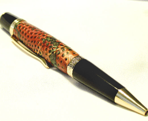

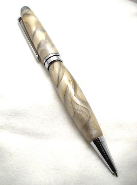

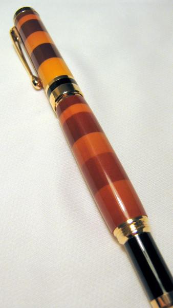

All the pens below are polymer and the different things you can do. You can make it as complex or as simple as you want. That's the beauty.
Well it does sound interesting.... I can see it now, another $1,000 in supplies :eek:
Kieth the third pen over with the tan leather look with the stitching is probably the sharpest blank I have ever seen on a pen! Looks like real leather! How will these clay pens fair with every day use, do they fade or chip easily?
I think this is a very interesting topic and would be very happy to learn more. I have even gone so far as to buy some clay but that is where it sits so far.
George they fair very well. I have been making them for about 3 years now. My wife and I have several pens that we use on a daily basis and they are as good as new. I work in a kitchen so mine has been subject to harsh temperatures, tile floors, and who knows what else.
The clay when it is cured is still somewhat flexible. Thin sheets of clay, when baked, can be bent back on itself without any cracking or breaking. I have tested several tubes after curing by cutting and tearing the clay off (for my own ease of mind and morbid need for destruction) and it takes quit a bit of effort. I usually finish with CA (except for the leather effects) and that helps as well.
Hope that helps! Thanks for the sharpest blank compliment. That style pen has somewhat become my signature and one of my best sellers. I have several that I distress for an aged leather look as well.
