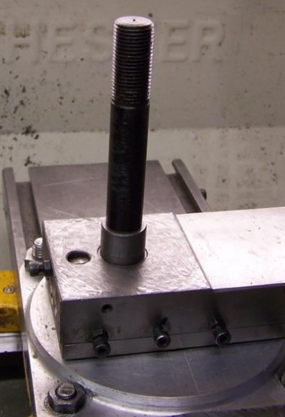

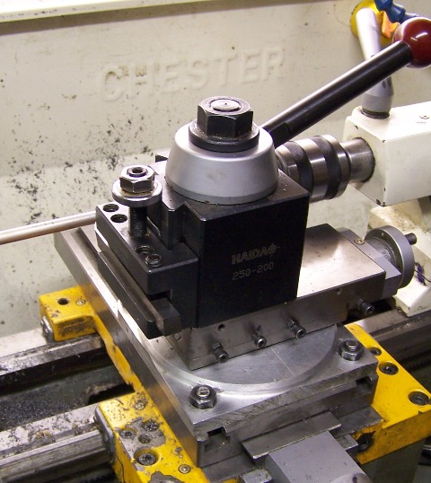

Very recently got a QCTP from Charlie ( that New London bloke:biggrin:). I was fed up with the poxy little block one that was on my lathe. I knew from the beginning that I would have to mod either my topslide or the new tool post or both:frown: But I really didn't want to mod the topslide and I wanted to be able to re-fit the original, just in case. Many people just mount these directly on the cross slide, but I still wanted to be able to do tapering so it had to go on the top slide.
I just wanted to show these pics in case someone else is thinking of doing the same thing.

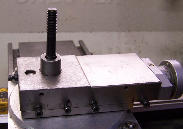

The existing TS has a 20mm dia bush but the QCTP only had a 16mm hole. So I simply bored it out.( For those that know how these things work, there was still plenty of meat for the inner sleeve to bear down on.)

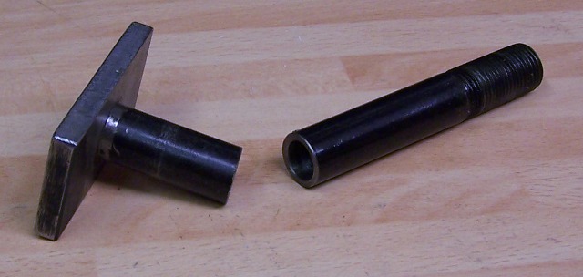

Next was to alter the 16mm QCTP bolt to fit over the existing 10mm bolt.
Just measured, cut, drill and tapped.
And that was that :biggrin:
I still want to re-position the locking handle cos at the moment, the best setting I can get is about the 2.30 position. I'd like it to lock at the 4 o'clock spot. But for now, I'll just unscrew the handle if it gets in the way of the tailstock clamp.
This is probably 1 size too big for my machine but I couldn't resist the bargain price:biggrin:. It was easier to fit/mod than I imagined and I'm glad I didn't have to alter the lathe at all.
If any of the metal lathe guru's spot anything I did wrong, then please let me know:wink:

Skip, we get the tool post locking handle interfering with the tail stock clamp screw on our 15 in. Romi / Bridgeports, if we have to work up close to the tail stock ram, we just unscrew the handle after locking the tool holder, I sure wish I'd seen that before you did, I need a good tool post on my Jet.

Ken, I'm not sorry I grabbed it before you got your beady eye on it!!!!:tongue::biggrin: But I'm pleased to know that if an old pro like you has a similar 'clashing-handle' problem, then I at least didn't mount it wrong. :biggrin:

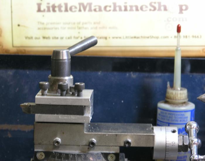

I adapted my QCTP according to Steve Bedairs' idea, like this one.
Advantage is that I don't need a spanner to do it up.
Agree with you about the locking handle, it will only lock in that position.
I have since made a new one for the part with the red knob, the finish on this one wasn't very good (my first "real" metal turning job) and I took care to place the handle in the 4 o'clock position when locked.
I notice that, like I use to do, you put your tool in the position where the other dovetail faces the front. I found that the dovetail gets in the way when truning thin spindle stuff, eg a closed en pen mandrel. I now have that dovetail on the LH side and the spare dovetail at the rear, gives more room at the front, particularly when using a live centre.
You'll note I'm still using the 2 bolt clamp, still haven't made a 4 bolt one. Have all the stell etc, one day...........
