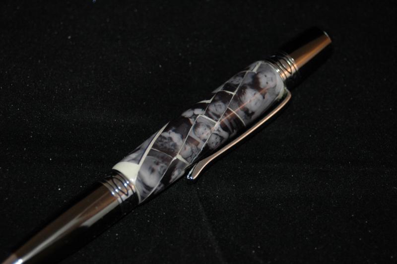

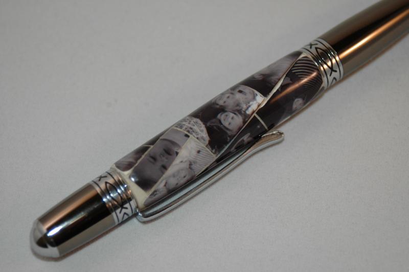

Made a pen for my wife using black and white photos of our little girls.
Comments welcome.

That is a fantastic idea. I would like to do one for my own wife, with your permission. Is it decoupage? Is it under CA? Cast in resin? (I hope not, since I don't do any casting).
Any hints would be appreciated.

I Turned wood down a little smaller than required, glued on pictures, applied layers of CA alternating thin and thick, sand and polish. Us wax paper when gluing pictures to keep them from sticking to fingers.
Try it and let me know how it turns out.
Thanks for the compliment.
Moye

Thanks so much, Moye. One of those with pictures of our daughter will make a very nice birthday present for the wife. What kind of glue works best for gluing pictures onto wood?
Dave

I tried several different glues and found the one that worked best for me was plain ole elmers white glue. also having some kinda pen insertion tool or something to hold the barrel while gluing on the pictures is a must. Also, have a popsicle stick handy to flatten out the pictures and remove any bubbles, kinks and ridges.

Another method is to scan the pictures make a collage, print on a label and cast in clear resin. You will get a lot smoother transition of picture to picture. There are many posts on how to do label casts.
