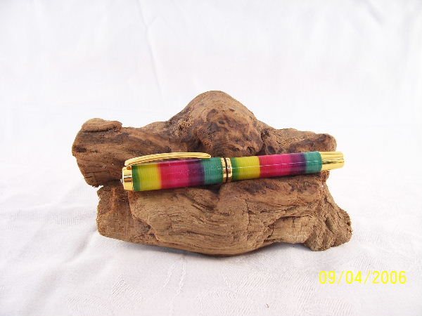

I did a couple out of knitting yarn about a year ago and some out of denim. Below is one of the yarn.

very neat.
Did you wrap the yarn then seal it with CA or PR?
That's more or less the look I'm going for with the yarn I bought.
