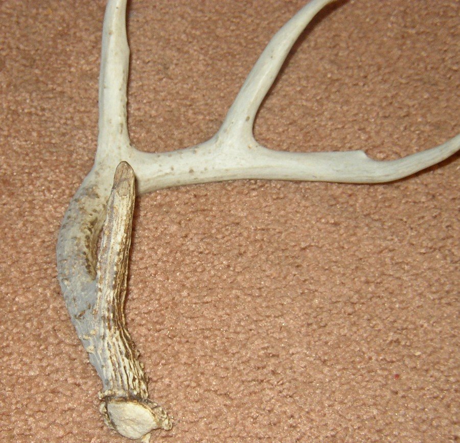

I was just given this rack and several others by a friend. I have no idea how to go about turning it into pen blanks. Where am I going to find the best "stock", is there "pith" to avoid, should I chose sections that are close to the final size of the pen barrel or go much larger for error room???? I would appreciate any advice, tips, tricks, warnings, tutorials etc. that could help me make a successful pen. TIA :D
Now for a picture of my rack :D:D:D
Dave:)

Horn is one of my favorite mediums... just make sure you have a relatively straight piece.. make sure your tools are sharp, wear a mask and have fun.
If the diameter of the horn is quite a bit larger than the pen you are planning,you could have some marrow to contend with... just lost of CA, sharp tools and a mask..
Without a reference for size, I think I see about 6 to 8 possible pen sections in there.. 3-4 pens.. I sometimes leave the bark, which will leave you with an odd shape to the pen, but you'll find buyers that will like that. Good Luck.. I just got about 20 or 30 pieces of horn on my last trip to Texas.. haven't started on anything yet though..

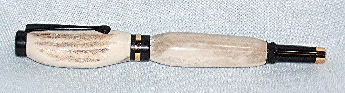

This is a fountain pen I have that I left the bark on..
<br />

The thickest end is about 1½" in dia, and that carries up to where it branches off the the rest of the prongs. Over all it's about 16-18" long not counting the prongs.
I'm afraid that the thickest end..with all the "bark", and the straightest section, will be turned all away leaving me with a very ordinary pen.
