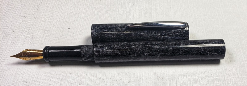

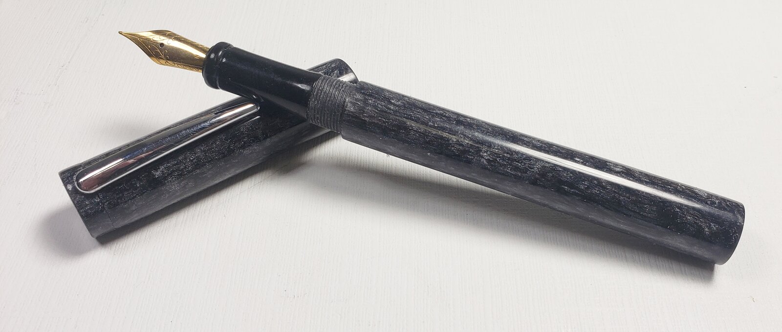

I like doing Kitless pens for some of the reasons people do not like them. I no longer do kit pens period. They are time consuming, and I am happy if I can finish one in a weekend. You can make them in any length or weight you prefer. Do you want a clip, then put it on. Do you prefer a roll stop, then put it on. The Kitless pens I am making are not meant to be for the average consumer. BUT to me this is a hobby as I already have a job.

Actually have about 6-8 hours in each. Lately I have been doing the turning and shaping on the cap and body on Saturday. Then do my section along with the sanding and polishing on Sunday afternoons. I am still figuring out where I am going and how best to get there.

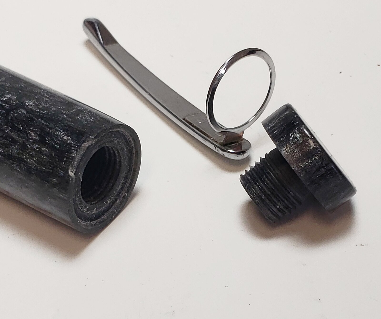

Kitless pens do not have tubes and several make them with clips. Many make their own clips and the rest of us use purchased clips.

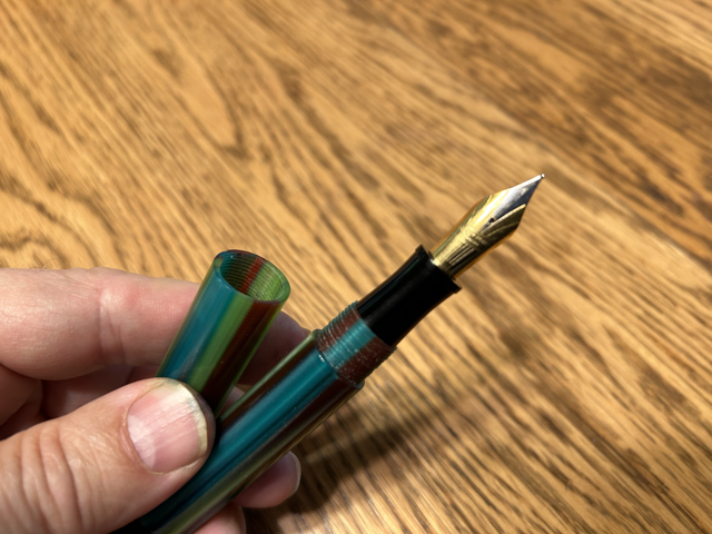

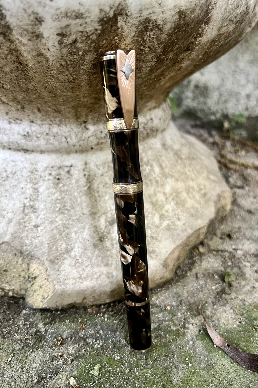

Because a kitless pen takes skill, a 5 year old or younger can make a kit pen
I'm at least 5 years of practice away from being able to even do a fraction of these:

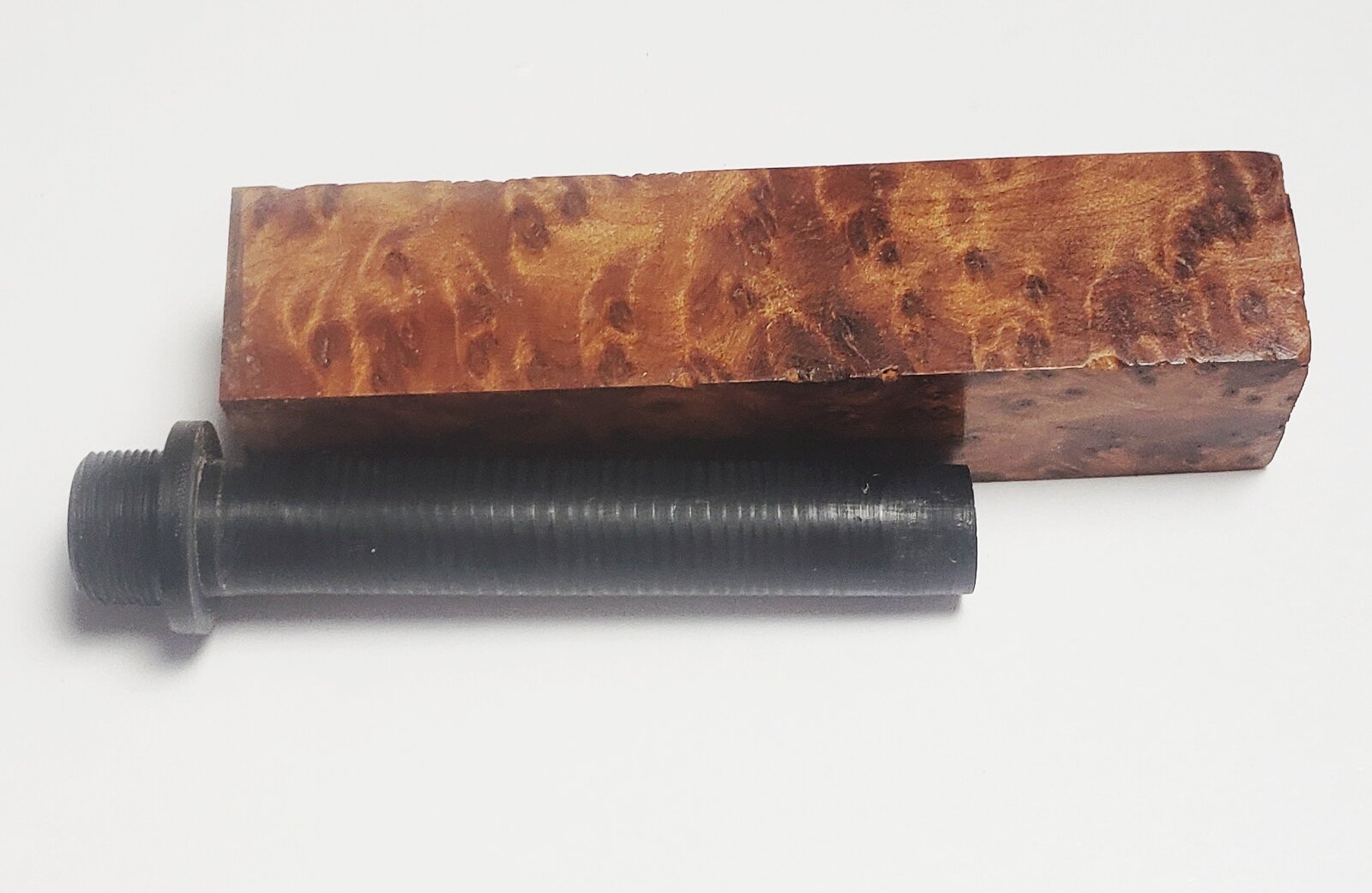

I would say that some kitless do have tubes, although they are not tubes from a kit, but they are inserts, made of brass or ebonite or even acrylic, to support either the wall thickness and/or the connecting threads.
I should have qualified my response, like you, that some do have interior supporting sleeves. I use sleeves (inserts) when using wood for the pen body and cap to give support and for threading. I do not use sleeves with the material will accept threading.
