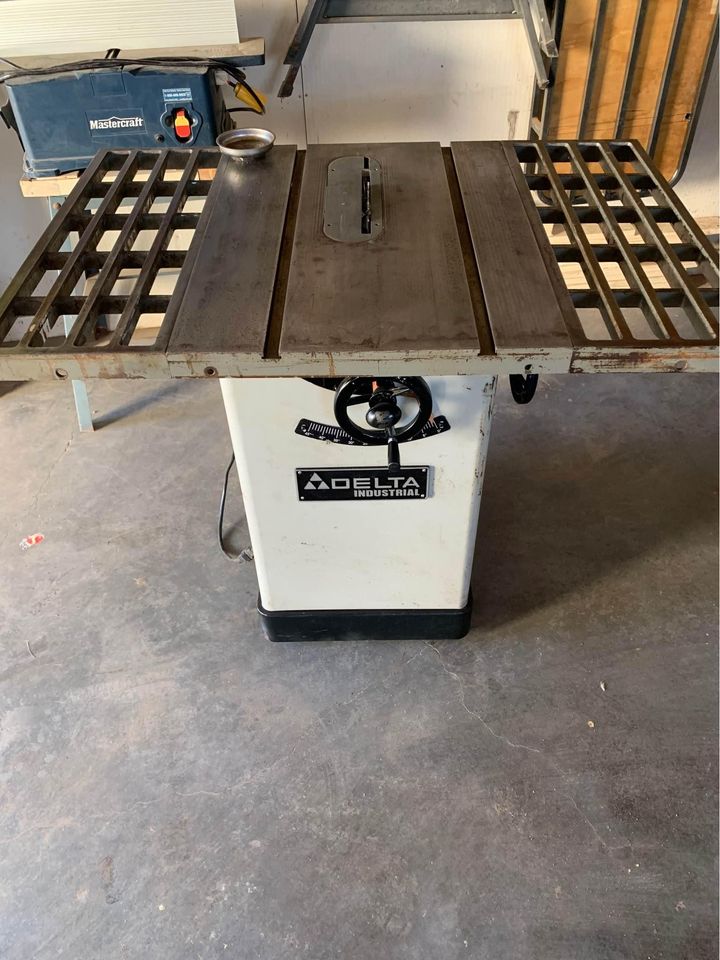

Keep looking until a better saw comes along like this one that was on FB Marketplace (Alberta). It needs a fence but there are decent aftermarket ones available. It is also a 110V 1 1/2 hp machine but if all you want it for is segmenting and lighter duty work it is fine. The price is $90Cad which is about $72US. It does have the open extension tables but the saw could easily be turned into a gem. Admittedly deals like this are rare but they do come up. If I didn't already have two table saws I'd be all over it.
