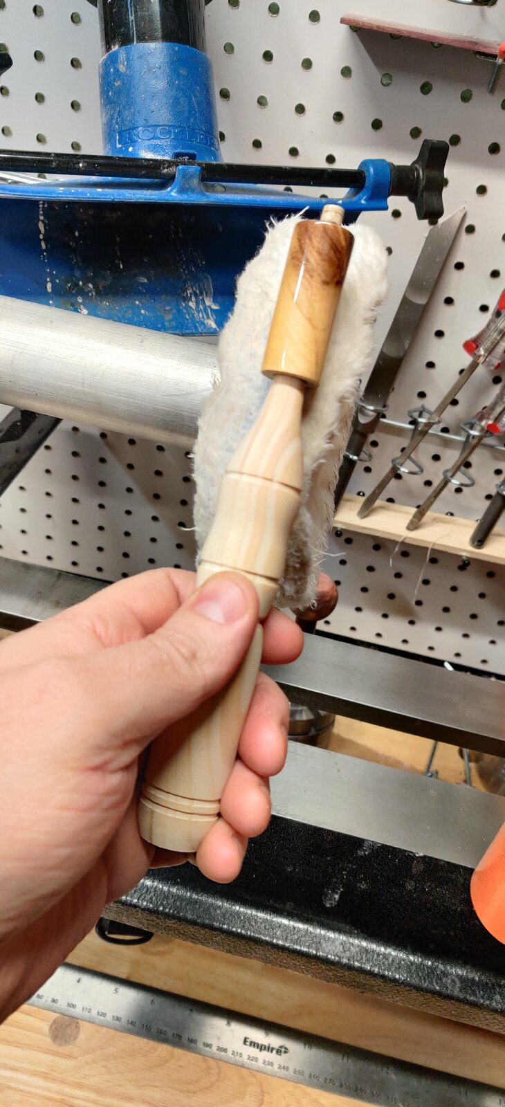

I can try to post some info on how I've been using them. Not too long ago, someone shared a video of a guy who created a little pen buffing tool that makes it easier. I turned one of those, and its made buffing pretty much a breeze. There isn't all that much to it, basically hold and rotate the finished blank against the wheel with a moderate amount of pressure, and buff until you are satisfied. There is some technique, and you'll get a feel for it once you start doing it, and over time you'll get better and better. Overall, though, its primarily about buffing against teh scratches (so if you sand with the lathe on, then you'll have radial scratches, so you want to hold the blank such that the length of the blank is in line with the wheel, and you'll clear out those remnant sanding scratches in a jiffy). Keep the blank moving, rotate it, adjust the angle a bit here and there, keep it moving, and you;ll end up with a brilliantly crystal clear shine in the end.
I try to use three wheels: one loaded with WD (white diamond), a white bar rouge, the next loaded with blue rouge (ultra fine finishing rouge), the final an unloaded (clean, no compound) for cleanup and final shine. Buff with the WD a bit, then the blue, then clean it off and your good to go. This little tool (I'll get some pics tomorrow) is super handy, and makes it so much safer and easier to buff (effectively eliminates the risk of the blank getting ripped out of your hands by the wheel when you catch the top edge, which is all but guarantee to be a blank ender!) For your kitless pen designs, you might need to think about the exact design of how you might want to turn such a tool, but its an easy turn. I just bought a cheap $2 dowel at home depot and made it out of that.

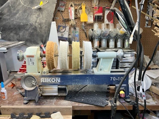

Wayne (of the IAP) kindly uploaded my submission on a buffing system (4 increasing finer compounds). Here it is in the attachment/instructions Buffer.jpg as well as a pic I took this morning using original wheels. I would apologize for the sloppy work area, but all my work areas are this sloppy. :)

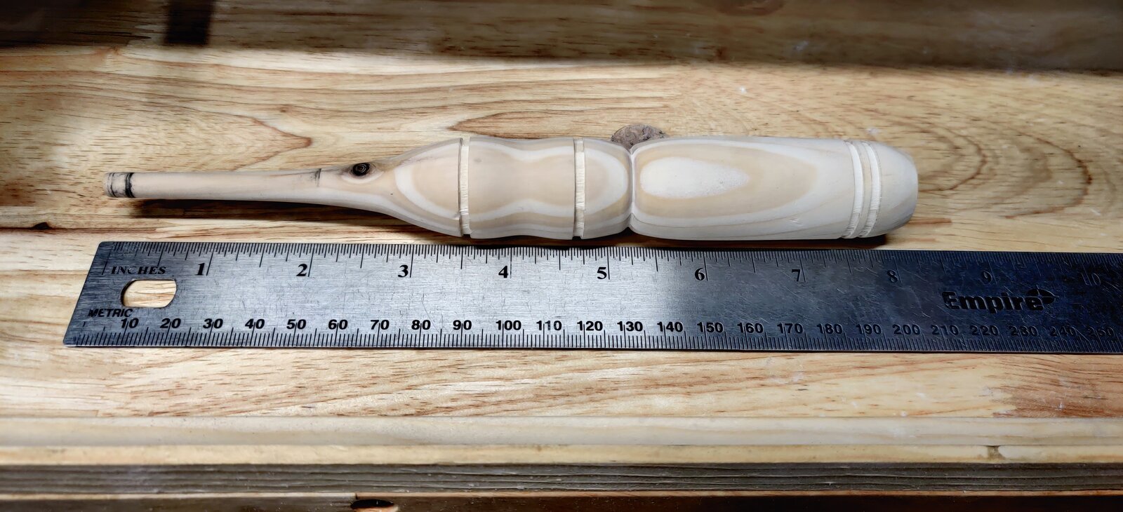

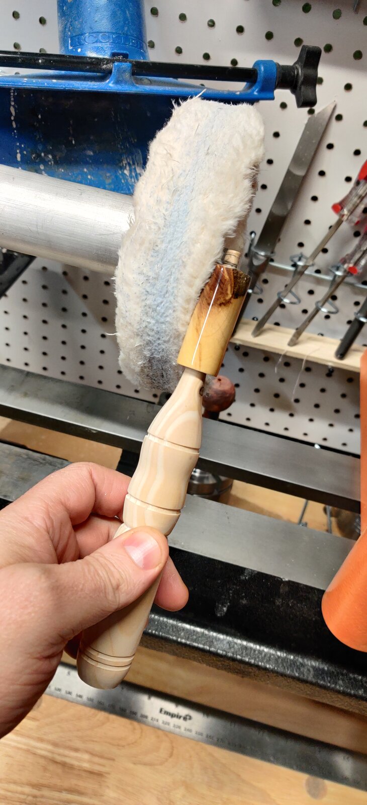

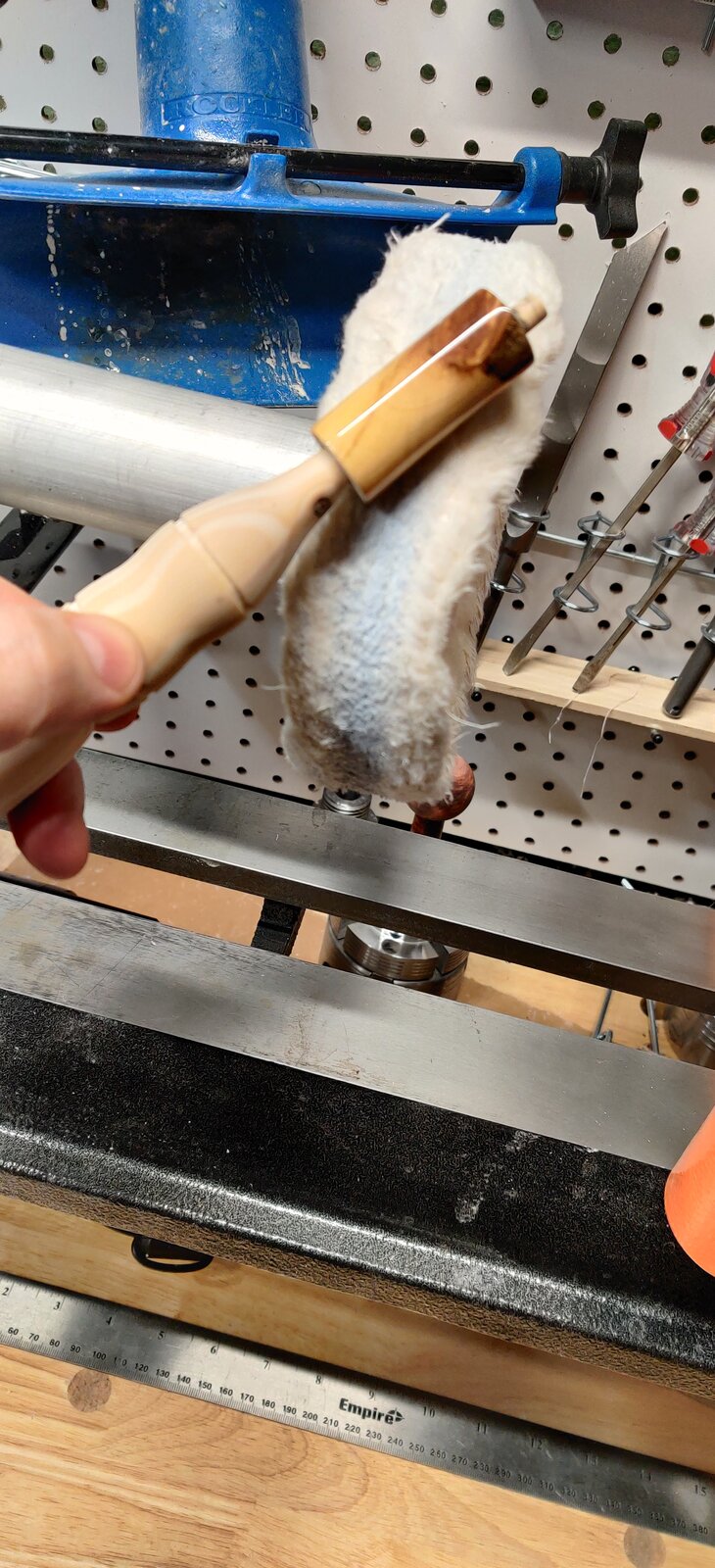

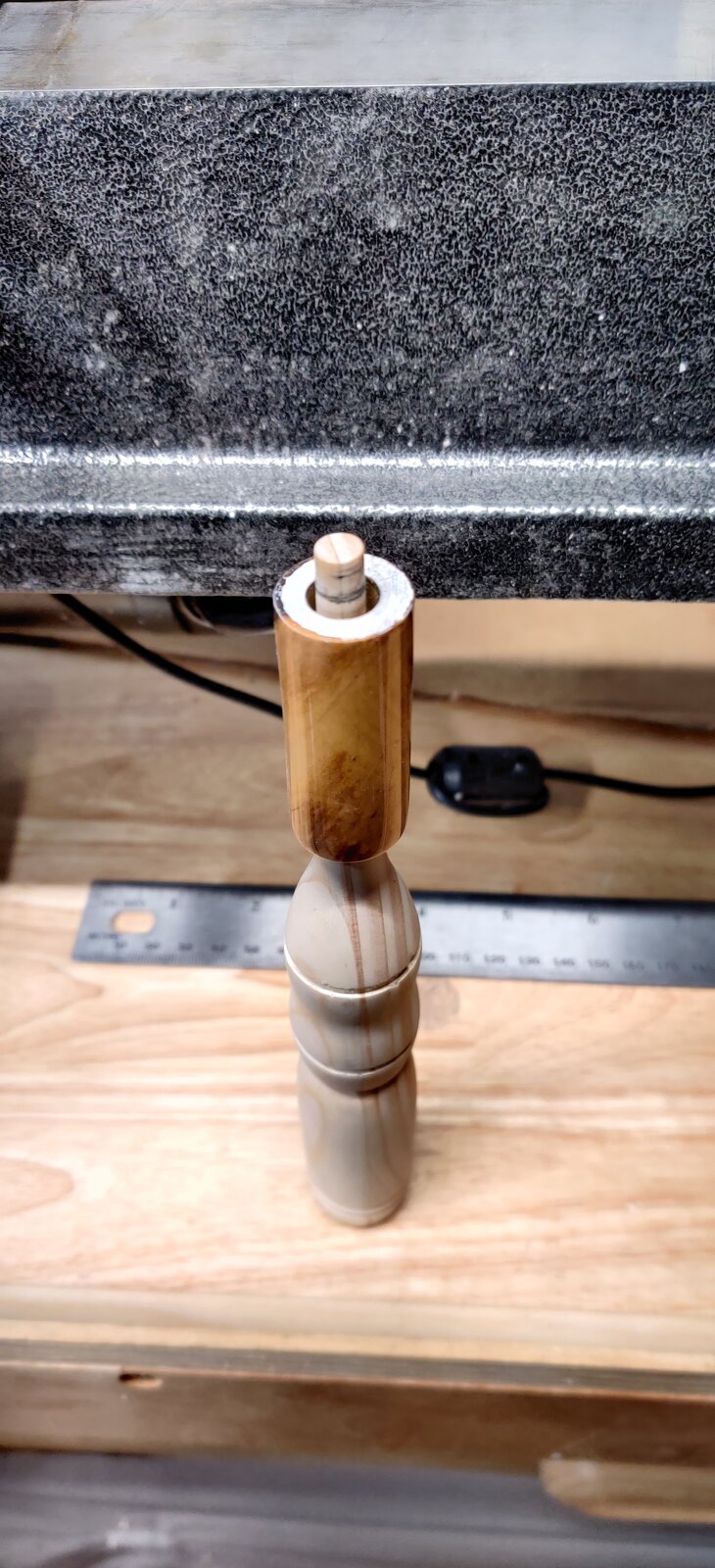

Oops, forgot to get you guys those pictures. Here are a few. This is just a quick rough turned tool. I intend to turn one that is a bit nicer, with a bit longer "needle" (and maybe one with support for even smaller tubes...this one won't do a 7mm tube). Anyway, makes it a lot easier to hold the blank against the wheel, turn it around, really get good coverage and fully buff out any scratches. FWIW, this is not my idea...got it from a video someone linked...oh, maybe a moth ago?
With this tool, I tend to buff at the top of the wheel. Before, when using my hands, I would buff at the bottom of the wheel, and really had to try hard to avoid catching the top edge of the blank. If the top edge catches while hand holding, its pretty easy for it to just get yanked out of your hands, which is usually devastating to the blank (it'll at least destroy the finish, even a CA one, if not the entire blank). With the tool, buffing a the top of the wheel, the blank is right in front of your eyes, and its easier to check it and see how its progressing. Also, catching (or even riding) the top edge doesn't matter much...the blank AINT goin ANYWHERE.
The tool I've turned here is ok, but its a bit short. I need a longer handle (say 10" rather than about 8" for this one), and better ergonomics, so I can get a good grip with one hand on the bottom part, and still be able to use the other to twist it around for good buffing coverage of the blank. I think a longer "needle" at the top (the part that the blank tube slips over) needs to be a bit longer as well, for some longer blanks (i.e. longwood, etc.) I intend to finish the next one with some wipe on poly for a bit better durability and longevity as well. Maybe paint the grooves as well, make it look a bit nicer. ;)
Anyway, it works really well. Its made buffing much easier and a lot faster than when I was hand holding the blanks. Also saving my fingers from all the buffing compound.
