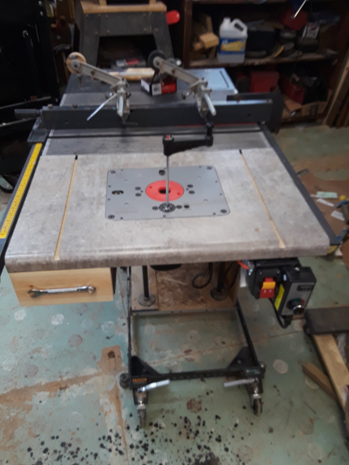

I bought angle iron to affix a "countertop" to my table saw (as a wing) and installed my router lift in that.20200207_155316.jpg
