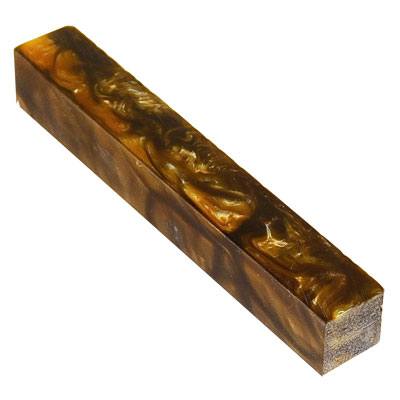

This one from PSI looks similar, but I'm not sure if it's exactly the same.
Read reviews if you buy this.
