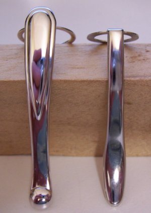

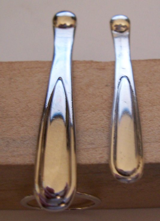

My favorite clip on the left and a clip from another kit.

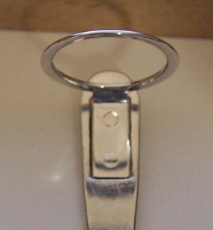

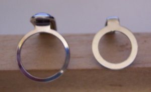

Here you can see the large ring that I don't want and the smaller ring I do want.

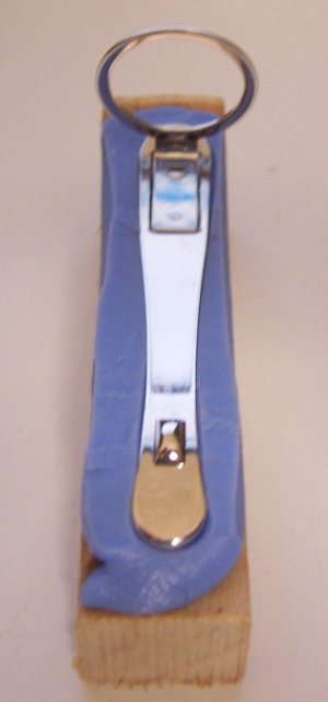

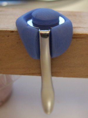

Here is the clip making an imprint in the mold.

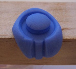

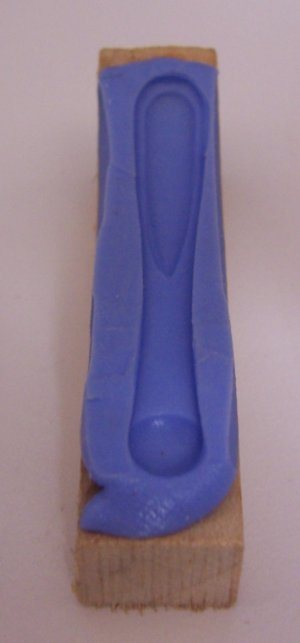

Here is the mold ready for the PMC

The material I used for the mold is a silicone impression compound called Mega-Sil.

Here is how the clip turned out with a little filing then buffing.
