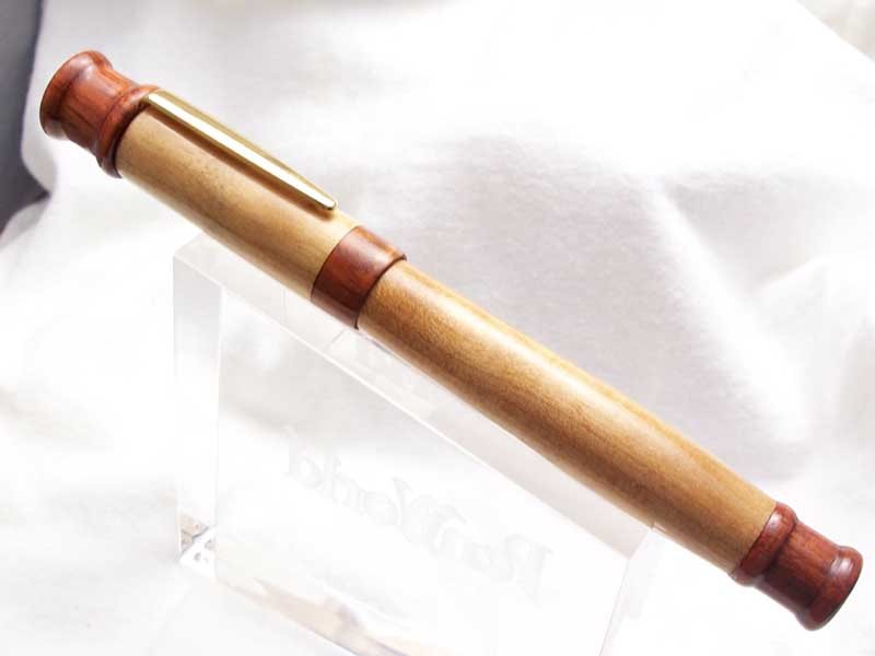

that's partially what i meant. i guess i should have posted a pic as i was looking at one right before i started this thread. the part from your pen i was interested in was the replacement for the silver nib housing. if you were to turn your lid as a hole and not have any metal showing at all and it still threaded over the nib/barrel, that's what i'm talking about.
hopefully jerry won't mind, but this is the first picture i found while searching in the photo albums. see how his cap hides any metal when put together?

Andrew,
If you are talking about the centerband, all of that was trimmed off from the threaded plastic portion of the centerband/coupler. The wooden centerband was opened up to go over the nib coupler and cover it completely. The remainder of the threads was pushed into the cap barrel to recess it further than normal. The only components from a ElGrande kit I used in this one was the clip, centerband coupler and the nib coupler. Let me know if that isn't clear.
