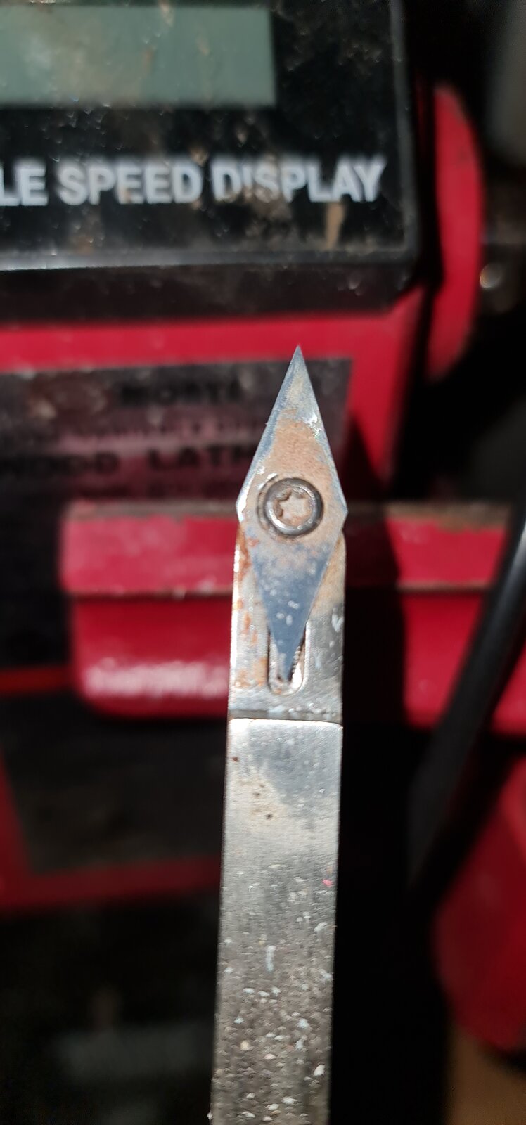

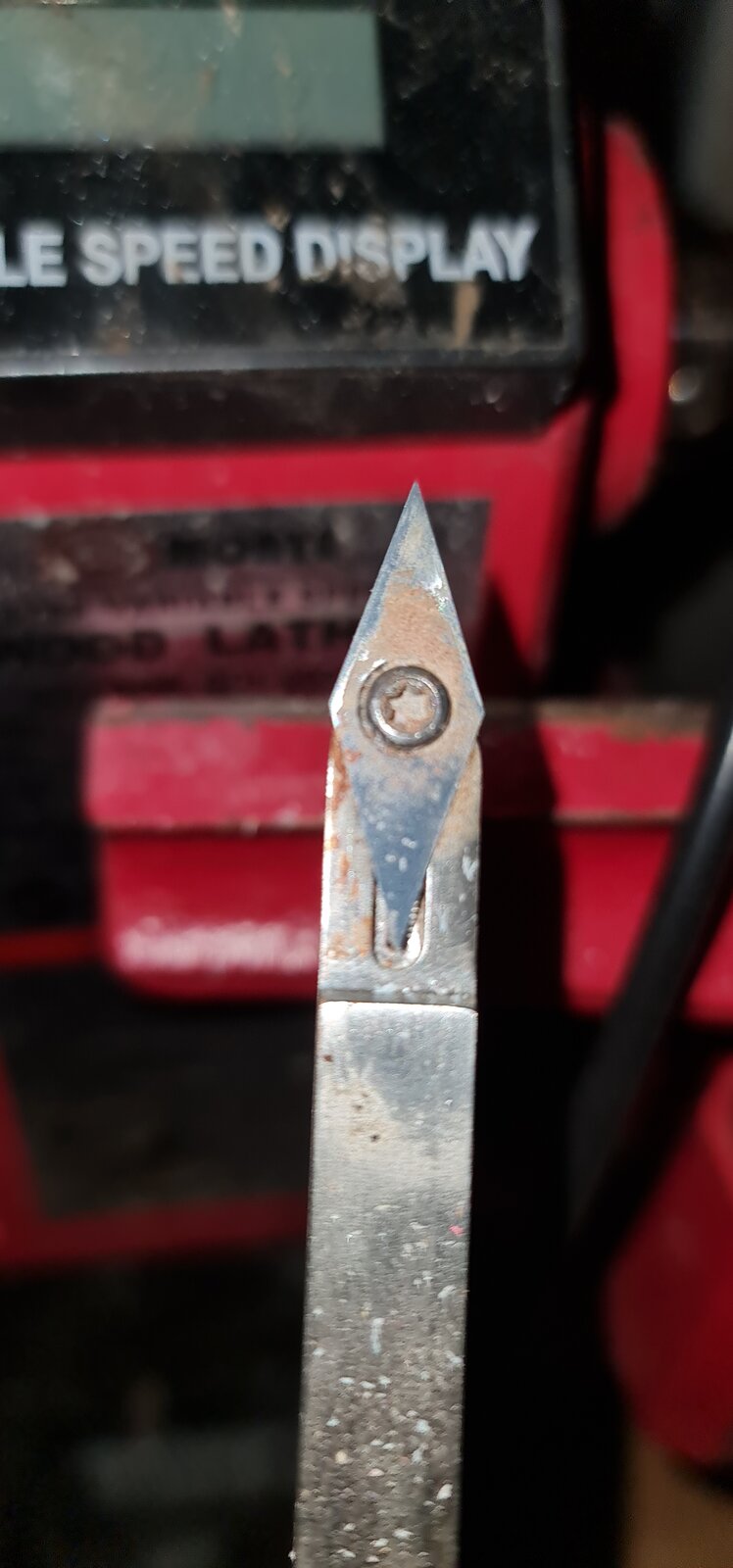

Does anyone know if there are truly pointy (not rounded) inserts for the EWT Full Size Detailer? I have the standard inserts for it, but they have a notably rounded tip...its not actually pointy, which greatly limits its versatility as a...well, detailer.
I thought I'd come across a truly pointed (sharp, puncture your finger kind of pointed) detailer carbide tip at one point, but I've never been able to find it again.

Carbide is a brittle material and a sharp point would break off too easily. Since they were developed from the machining industry I doubt you will find any with a sharp tip. A small radius sure.
Will this one do assuming you have a tool to hold it?
They have the tool too.

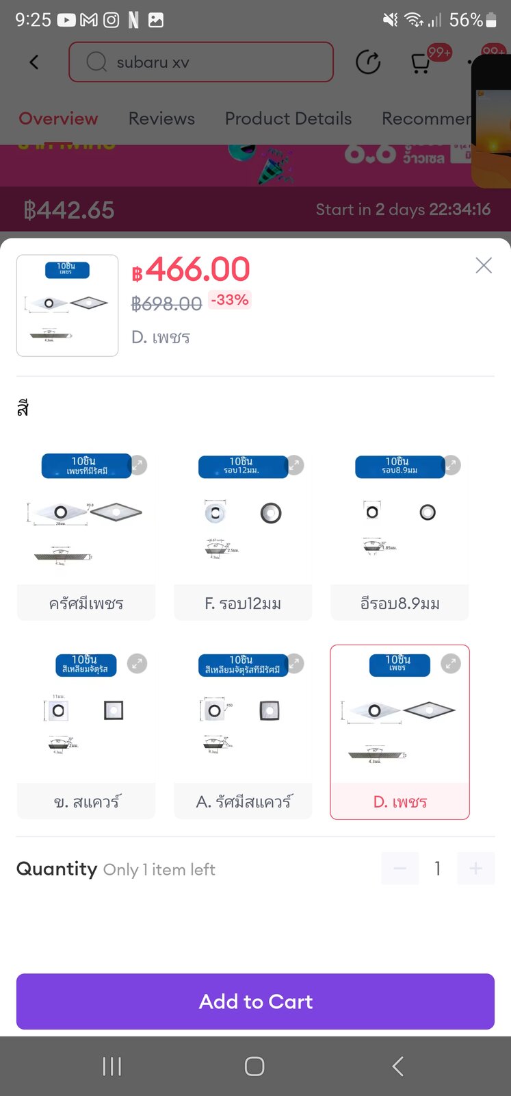

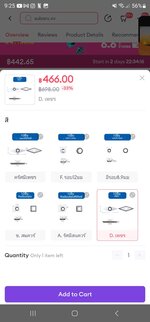

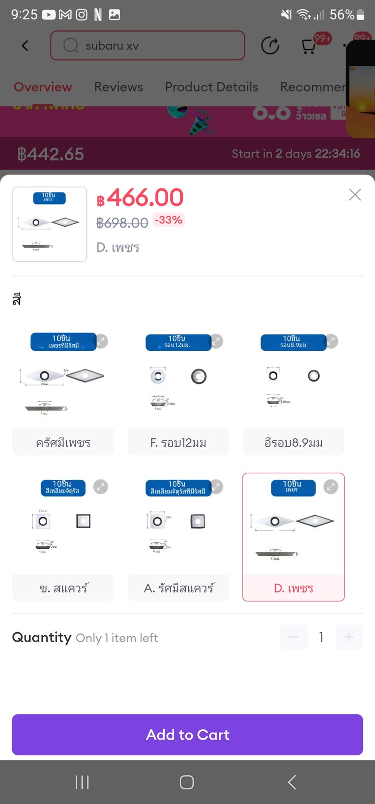

I have the diamond from TASP and use it like stole it; havent broken it in 6 months. I cut rock-hard stabilized hardwoods, epoxy resin + hardwood, and mica filled polyester resin.... turning squares into circles daily. 10 bits are 466THB around $15USD.
