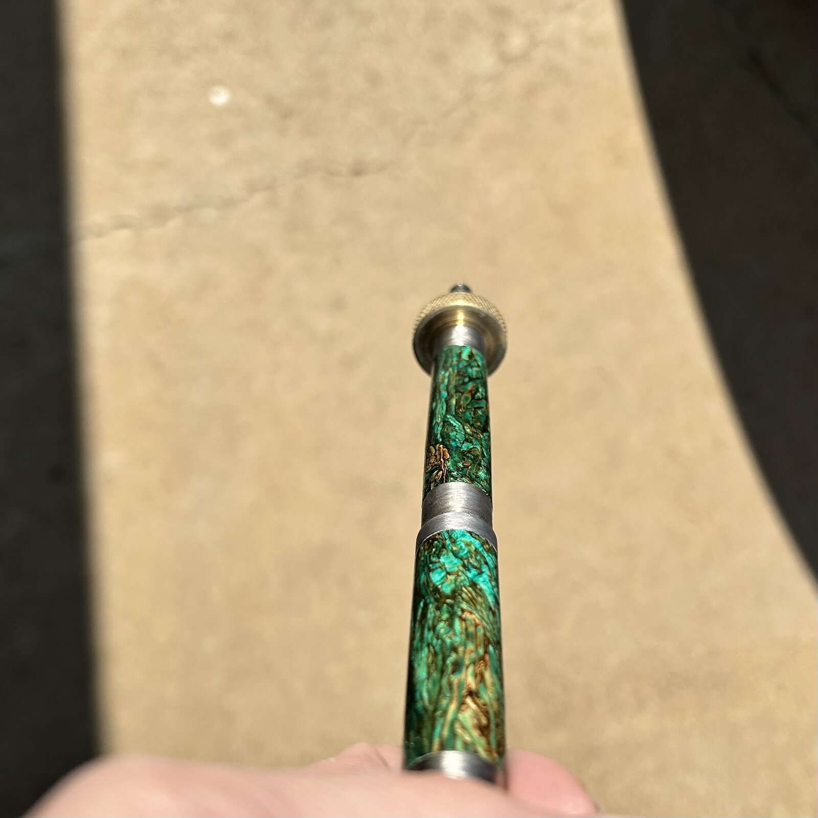

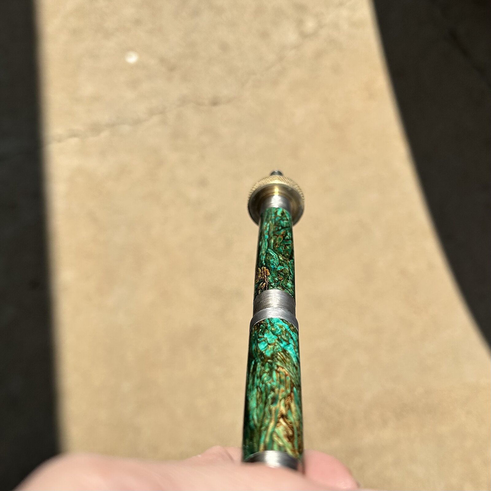

I've watched every video I can find on turning hemp. I was advised by the hemp vendor to use epoxy and not ca for gluing tubes, drilling on the lathe and to turn between centers. I recently turned two and had issues. I do use epoxy, I did drill for the tubes on my lathe, I did not turn between centers as I don't yet have adapters. Both blanks cracked at the cap end during the drilling process, I used ca to glue the crack and applied a clamp. I found hemp needs a sharp tool, I used carbide and I found that sanding close to smooth once in awhile during turning helped with less chipping out, but during the turn the body had a complete blow out. While I am new to turning, I did lots of research before starting with hemp and felt I was aware of the issues, but still it was a struggle. I'm thinking it is probably a really good idea to turn between centers as the body is closer to the tail stock and thus the vibration is more intense. I think this material is prone to cracking due to it's structure, more like particle or wafer board....sort of bits and pieces pressed together. Thoughts? Input?

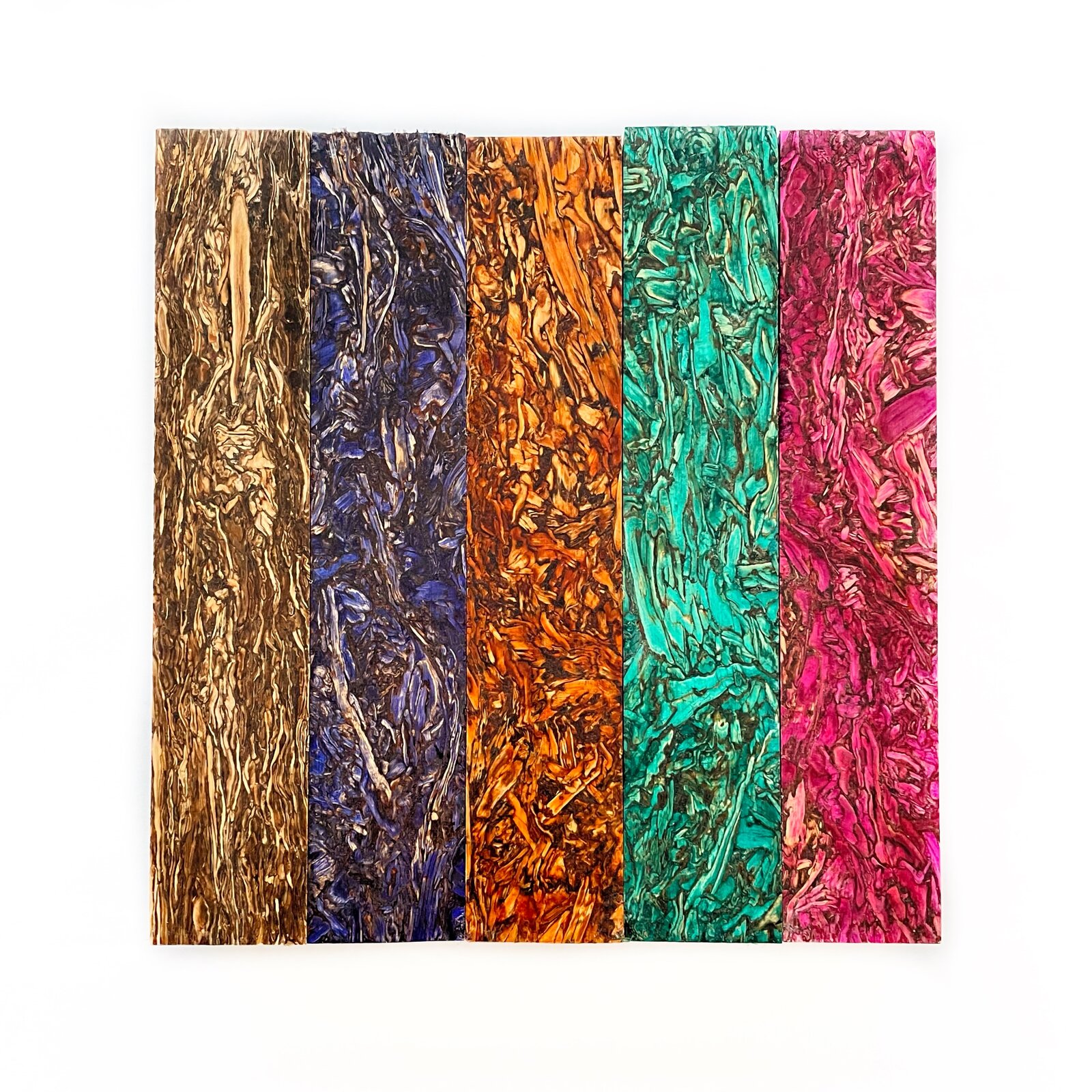

I'm not on here much but you can always hit me up via email or Facebook. I've turned more hempwood than anyone. The tailstock end will always give you trouble if you're using a mandrel - that's why I recommend using TBC. It's a challenging material - it's thousand of fibers pressed together with adhesive in a hydraulic press. Sharp tools and taking your time are the only options for success

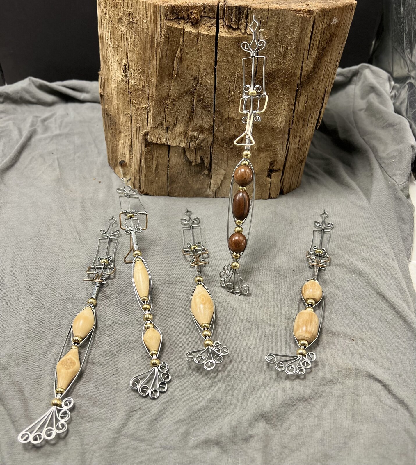

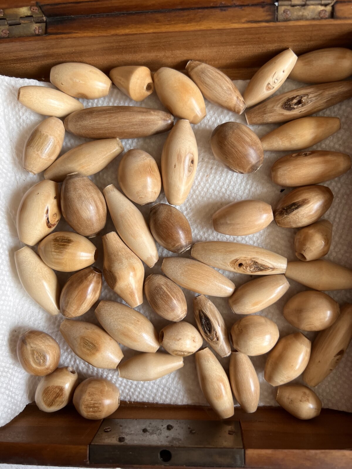

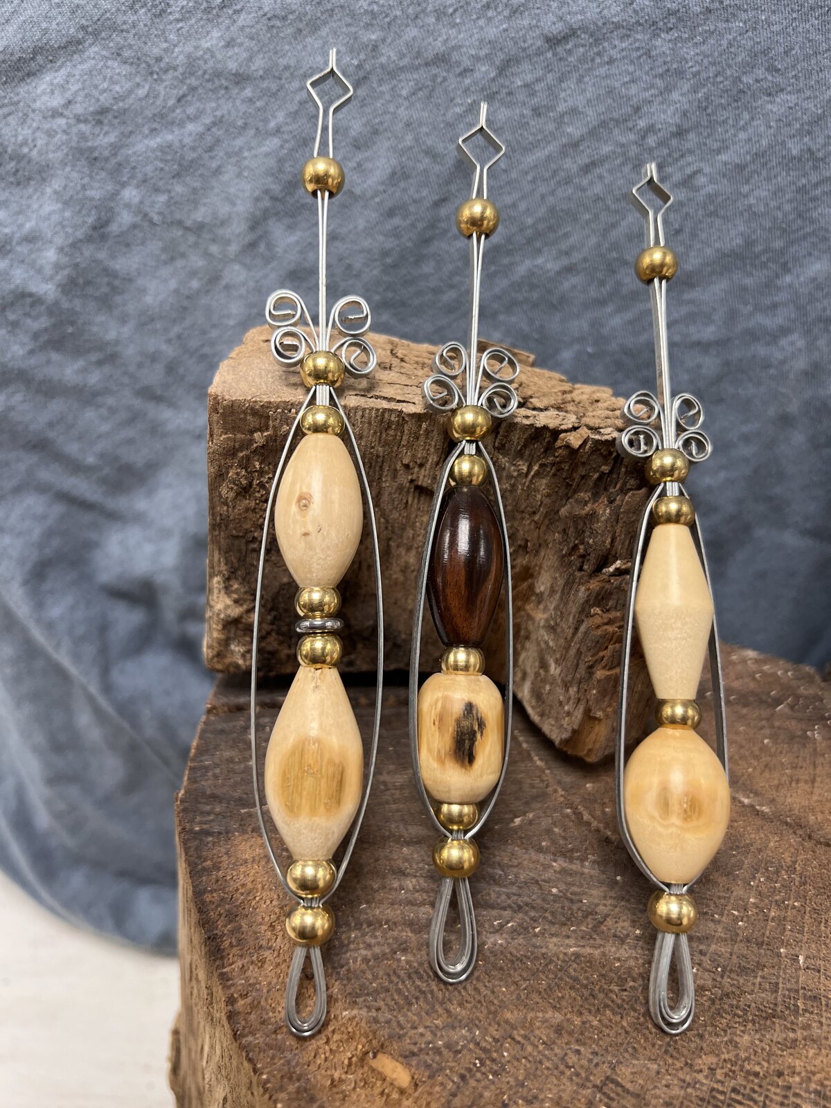

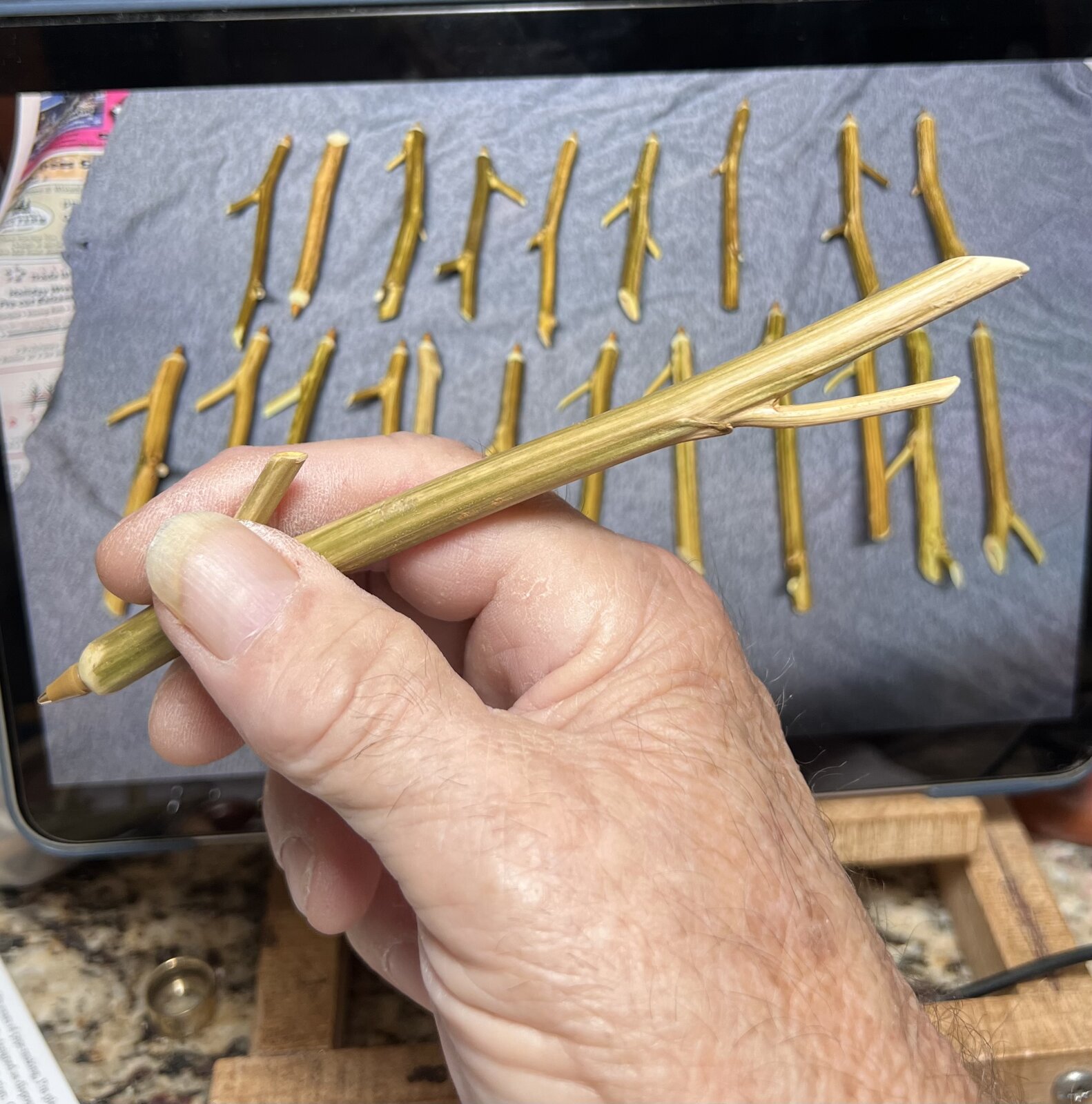

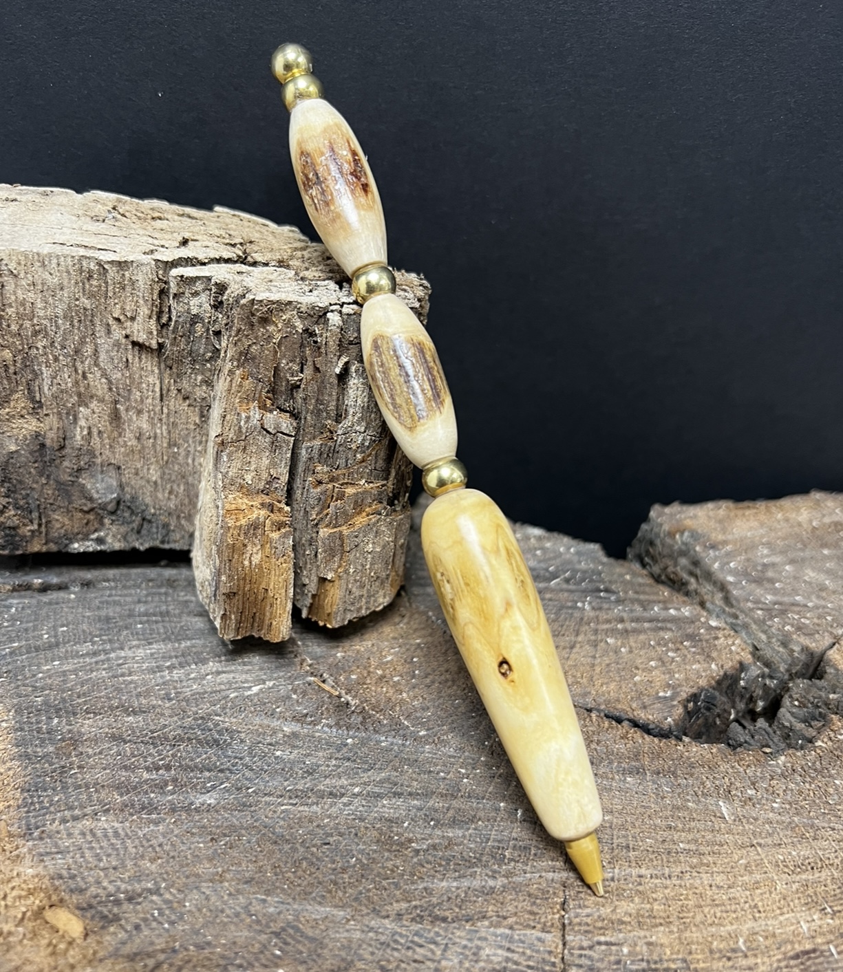

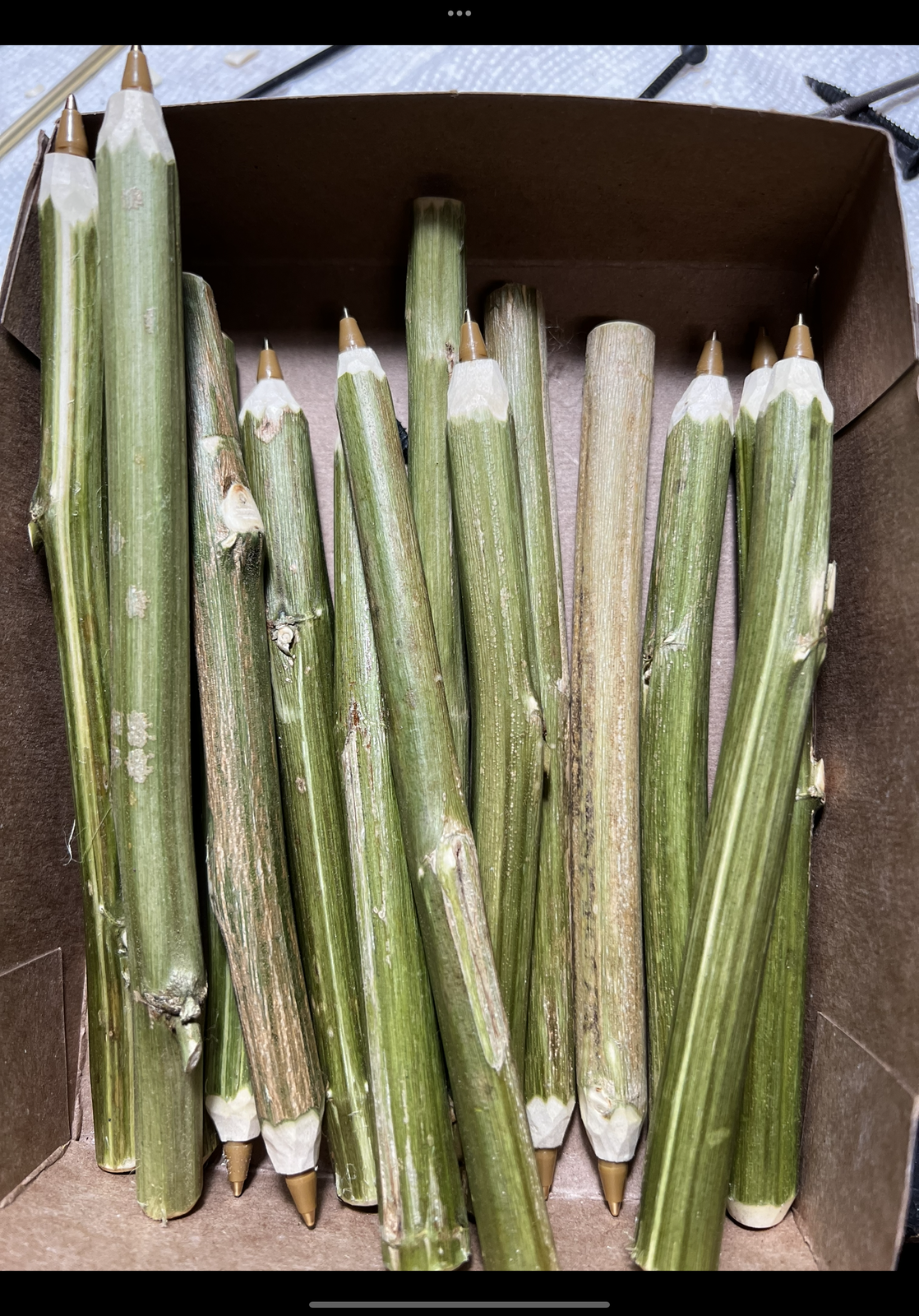

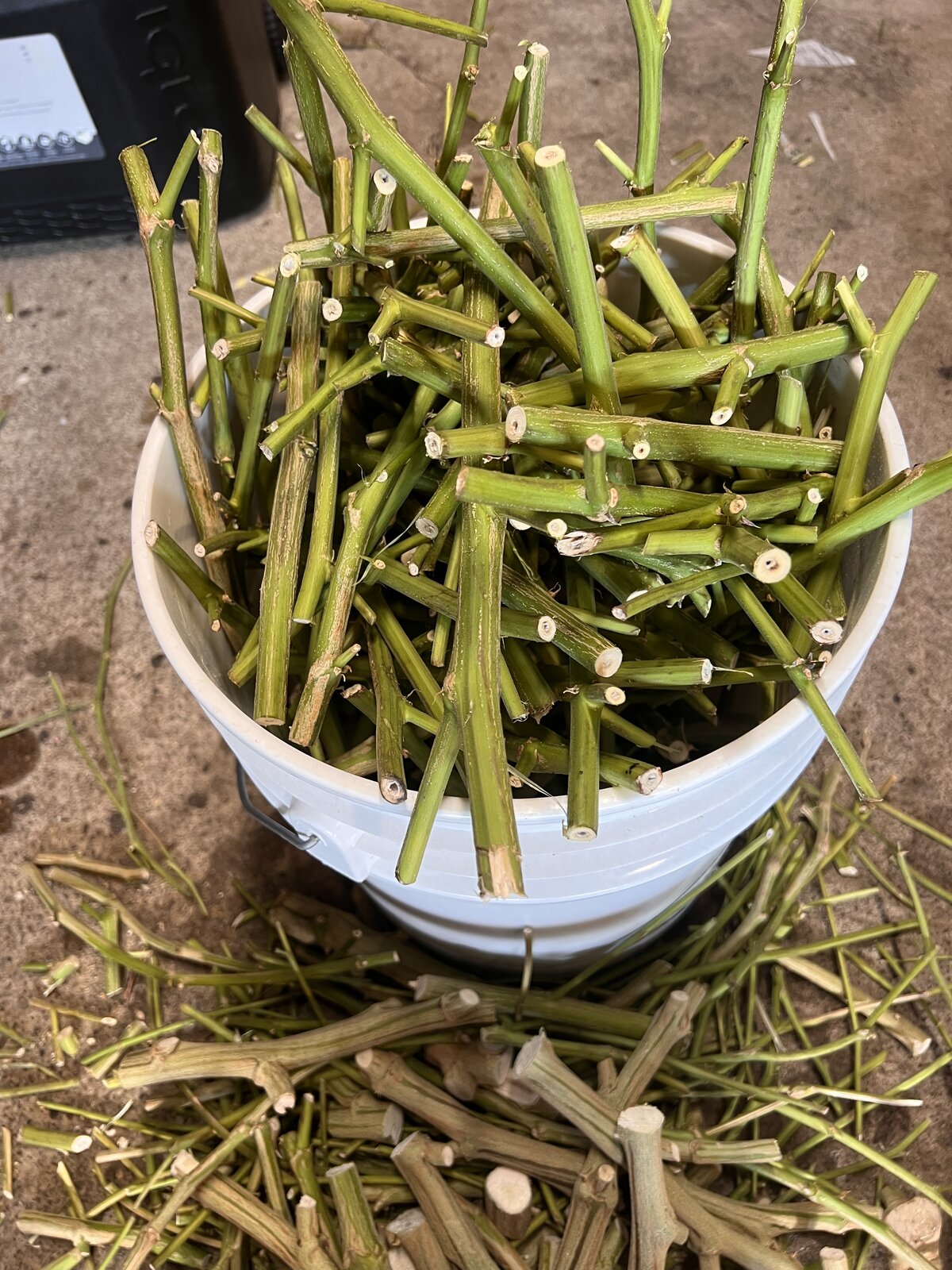

I've stabilized some on my pen blanks for over 10 years. I stabilize hemp and cannabis stalks cut to 3" pieces to make beads for cannabis pens & clips. The lite colored beads are from cannabis stalks.

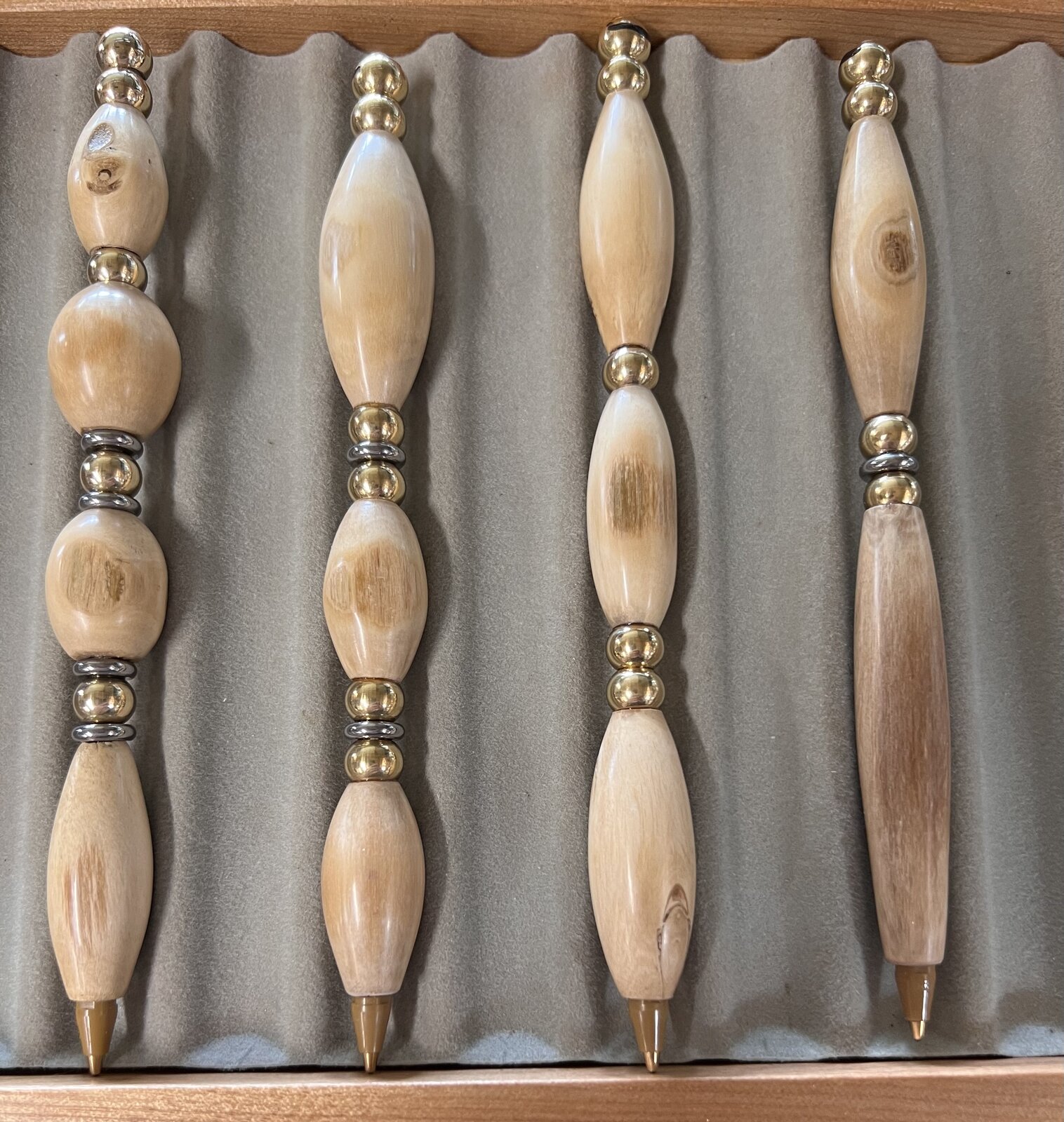

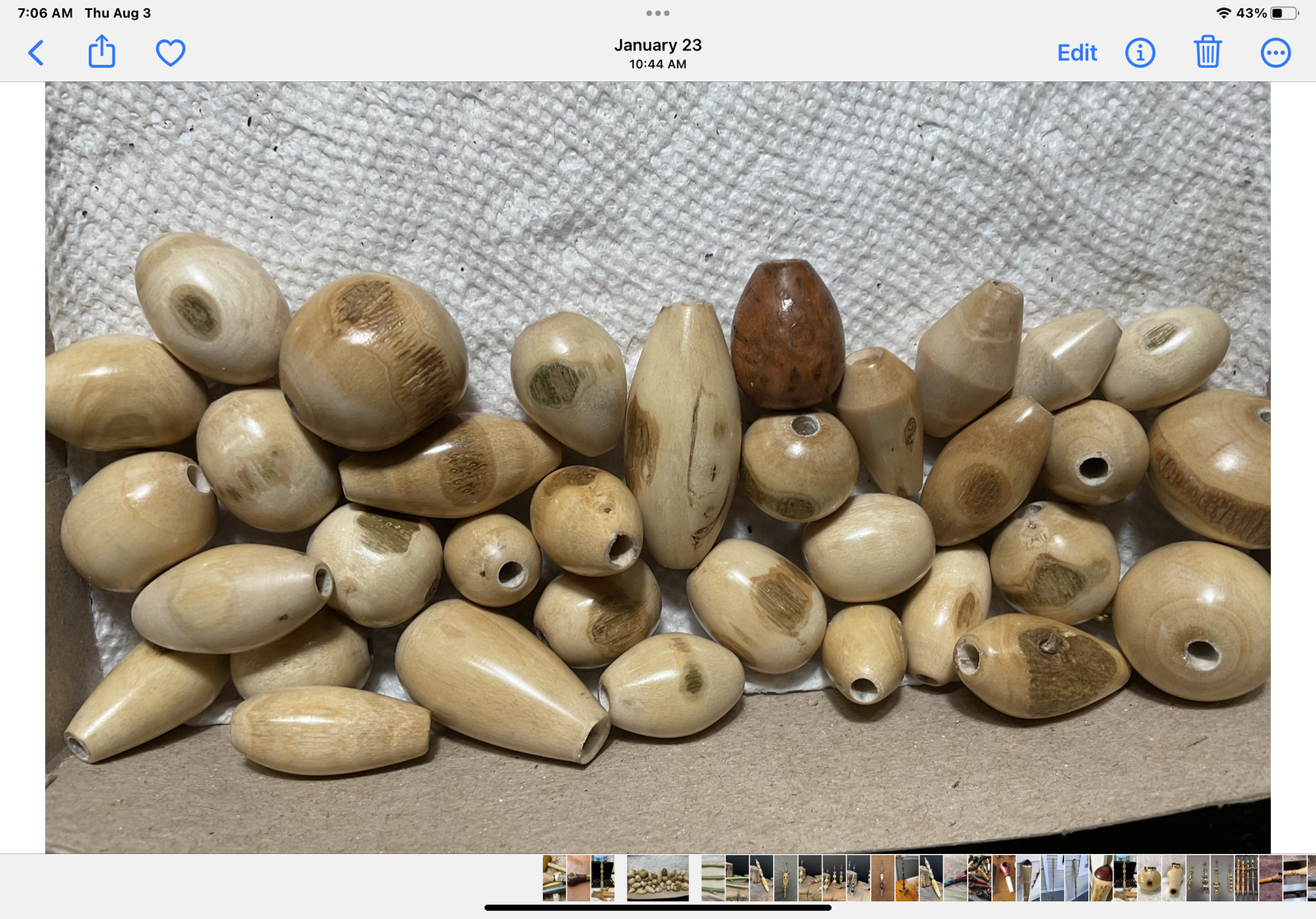

I've made cannabis beads for almost a year. I don't find it any more difficult working than most other woods as long as it has been stabilized. The only problem I have is the outer skin outer fibers pulls up then sanding starts.
