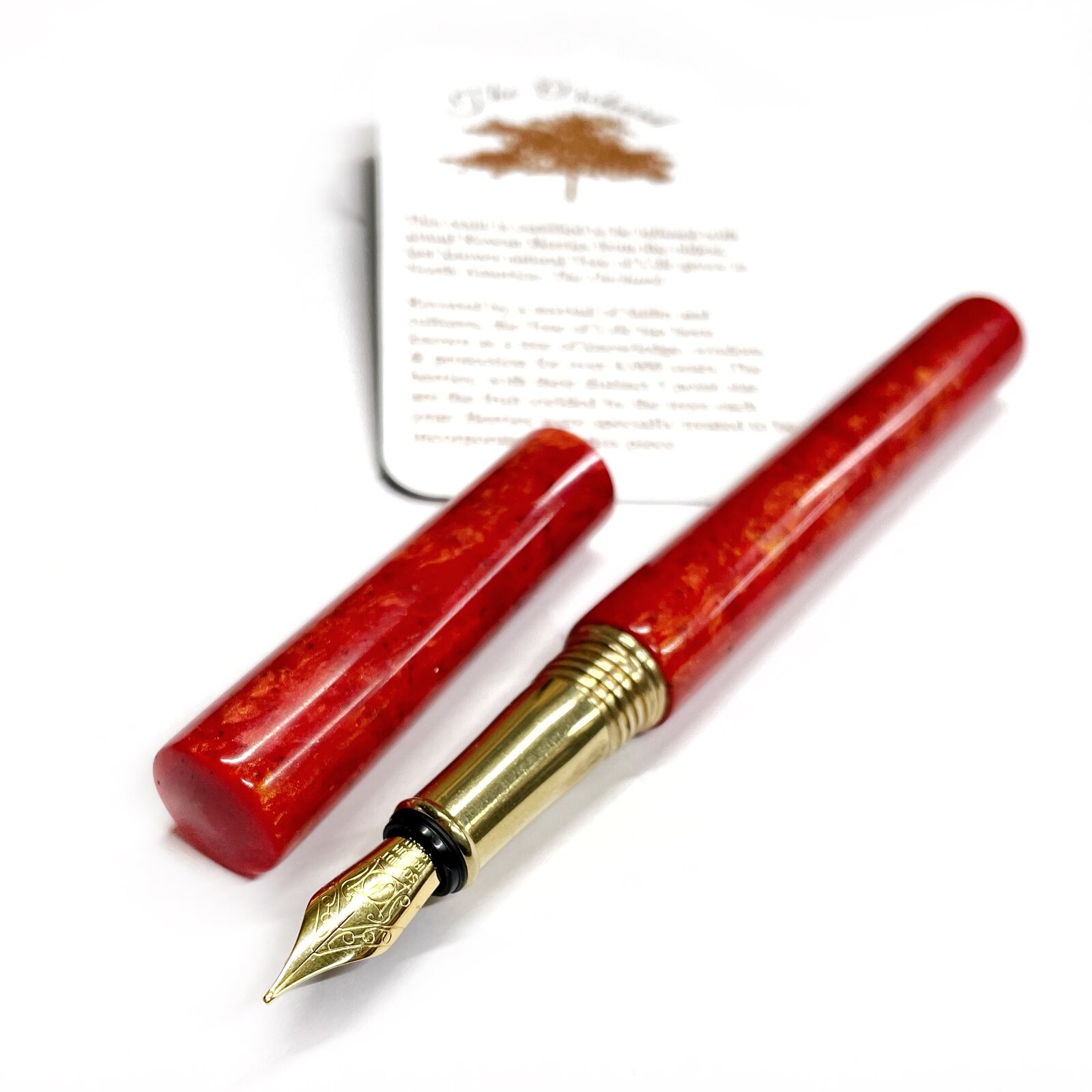

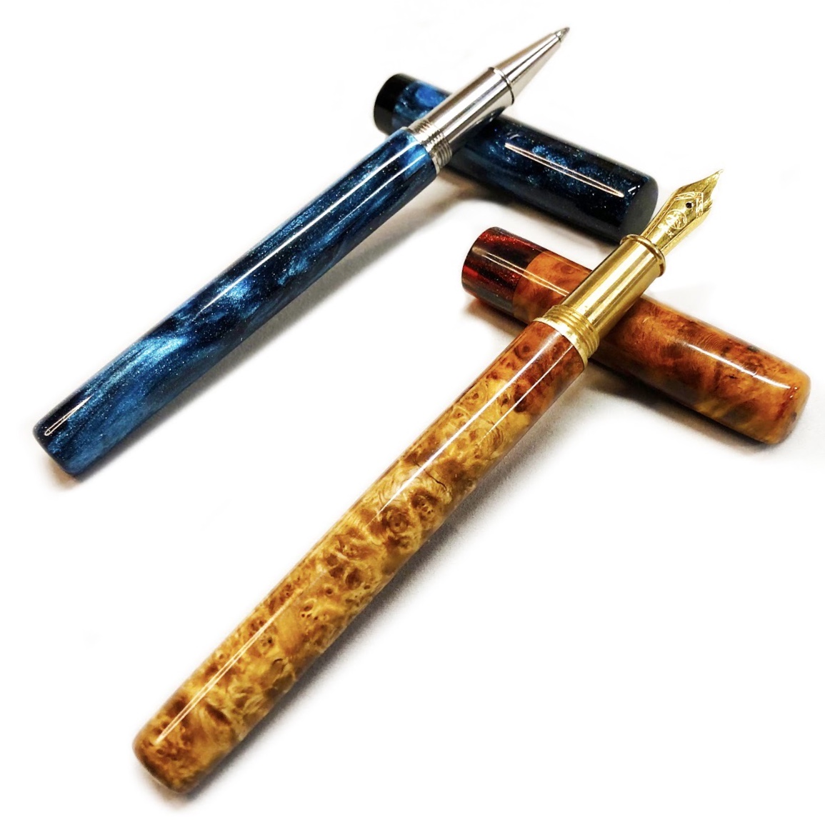

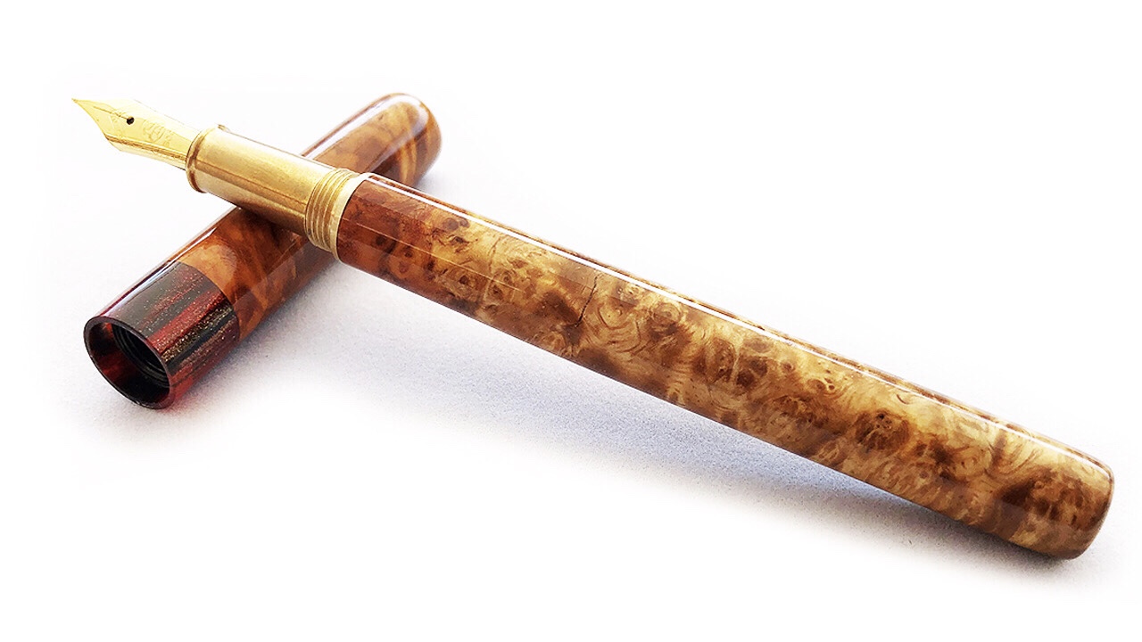

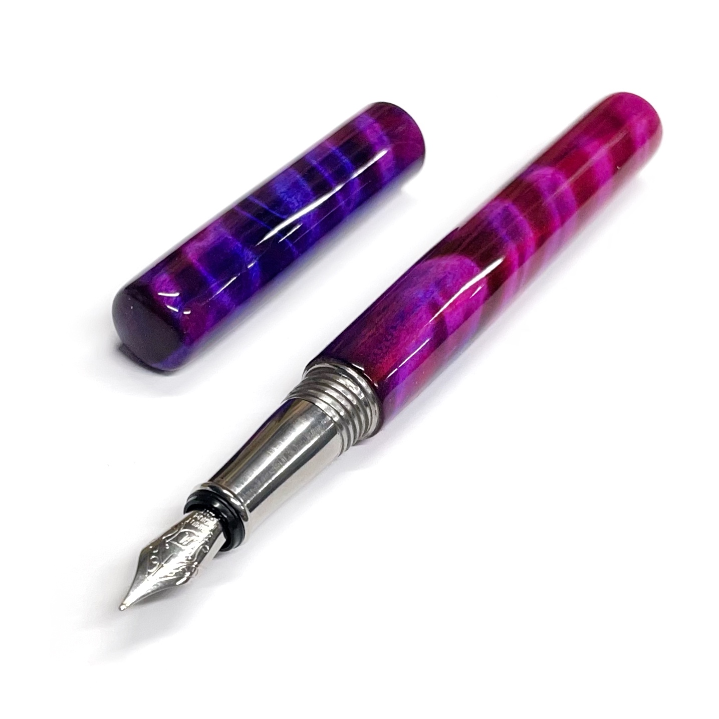

Hey Mike! I own Bullseye Turning Supply and I appreciate the mentions above. If you have any questions about the Apollo let me know. It's American made and not nearly as challenging to make as it may look. You can check out my instructional video here

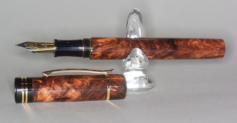

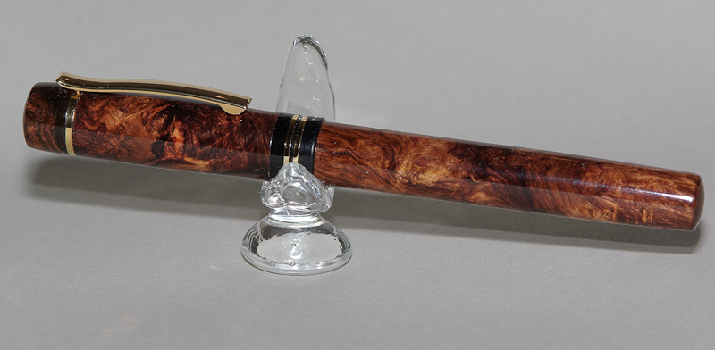

I made this Churchill kit into a closed-end pen. Drill the barrel for the regular tube, and just a little further with a 7mm bit. Then you can glue a short piece of slimline tube deep inside. This will allow you to adapt a regular mandrel by grinding the tip into a chisel "drive spur" and just use a single barrel bushing at the opening - no special "grabber" mandrel needed.
View attachment 351926View attachment 351927
Oh, that Churchill is nice!!!

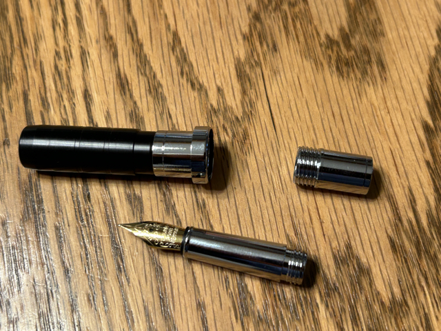

Okay, I have a question... if I want to turn an Atrax or some other kit pen, can I leave the brass tubes out, and glue in the bits and pieces? Or do you recommend using the brass tubes, and pressing in the bits and pieces? I would be using acrylic, so nothing fragile!
It looks like these are the only 2 bits that need gluing or pressing in:
Mike...
@duncsuss
Is that a #6 nib I see on your Churchill?
Mike...
mikeschn
Jan 6, 2016
250
Lake Orion, MI
@duncsuss LOL
It's a shame that Berea doesn't give the nib sizes....
But the section looks the same as what I have on the El Grande, so I'd agree, it's probably a #6.
Mike...
Mike...
When I've made closed-end pens from kits, I've always included the tubes.
Two reasons. First, I only work in wood, and the turning will be very thin and therefore not very strong if the tube is omitted.
Second, the visible/functional components such as the section, and the coupler (if the cap is a screw on) are sized to press into the tube, and if the tube isn't there, you would have to find some other way to assemble the pen. I suppose that is possible, but not something I would want to do.

I recommend that you always use a tube as much as possible. If I doubt whether the wall is strong enough, I glue the insert in the tube. Sand to size first.

Thanks for the suggestions... I just came up with another reason to use tubes...
I use a couple pin chucks on the lathe...
If I don't use tubes I have to make the holes larger so there is no press fit when assembling... and then when I go to use the pin chucks, they don't hold!!!
