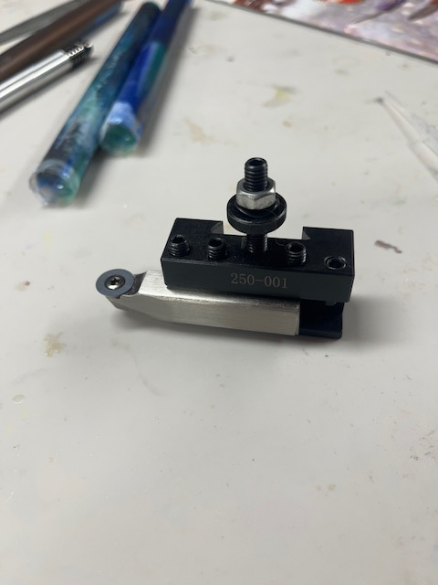

2. I personally like HSS for the metal lathe on acrylics. I find that carbide does not give as good of a finish...for me. It takes practice to get good cuts and a good STEADY feed rate for the material. Mess with the angle of the tool until you find what works best for you. It is also vital to use lubricants to get good cuts. I flood it when I am cutting with anchorlube mixed 50/50 with water or Tap Magic if cutting metal. Take shallow cuts at first and figure out how deep you can go and still get a good finish.
The other thing I have done that has been successful that someone mentioned here was buy a woodturning carbide tool, cut off the cutter and mount it in the metal lathe like a standard cutter. This is what I use for wood and alumilite on the metal lathe:

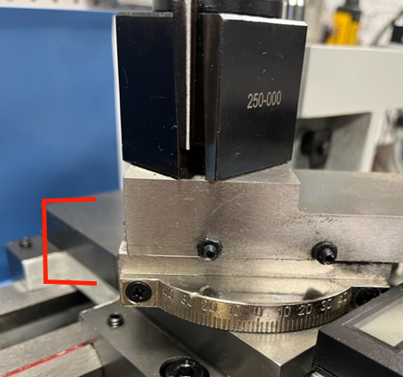

The compound slide is the top layer where your cutter is attached. I find this to be the weakest point of the mini lathe. If you have this part coming out very far from the center, you will get more chatter when cutting, and it gives poor cuts. At least it does with my Seig style lathe. Try to keep the compound slide centered over the cross slide as much as possible, which will improve rigidity to the mini lathe and produce a better cut...at least in my opinion from dealing with my lathe. You can adjust those screws at the bottom as well if there is any play in the compound slide.
I didn't realize this when I started and struggled trying to figure out why my cuts looked so bad. Everything led back to the compound slide. Just another idea to think about when troubleshooting.
